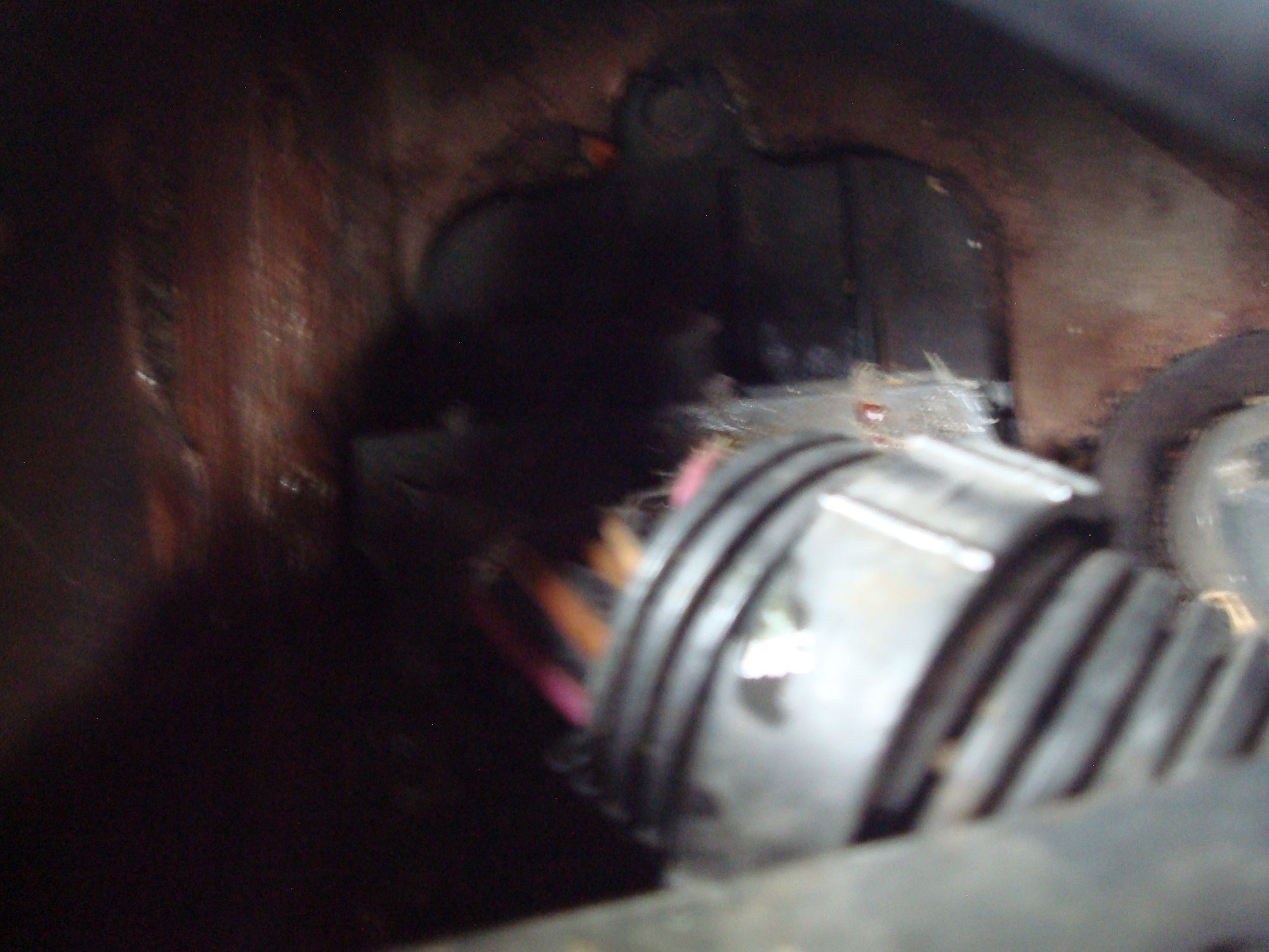

The engine is a 2.0- Liter 4-cylinder. It may not start if engine compartment is damp. I let it sit for a few hours & it will start & run well. It is definitely a no spark condition & I believe it is an electrical bulk head wiring connector problem. I believe it is in the right connector at the fire wall of the car. I am trying to separate the male from female connector. I have removed it from firewall and tried to separate halves with no luck. Does anyone have ANY suggestions on that? I can provide more details & pictures of it.
Right side electrical bulkhead connector at firewall
Right side bulkhead connector at firewall
Note: RTV clear silicone applied over wiring which did not help to waterproof
