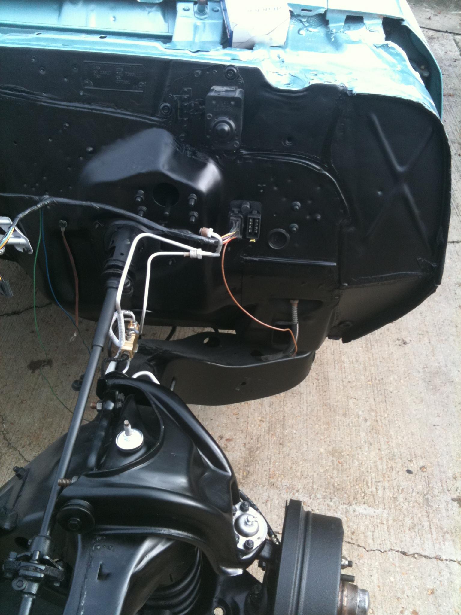

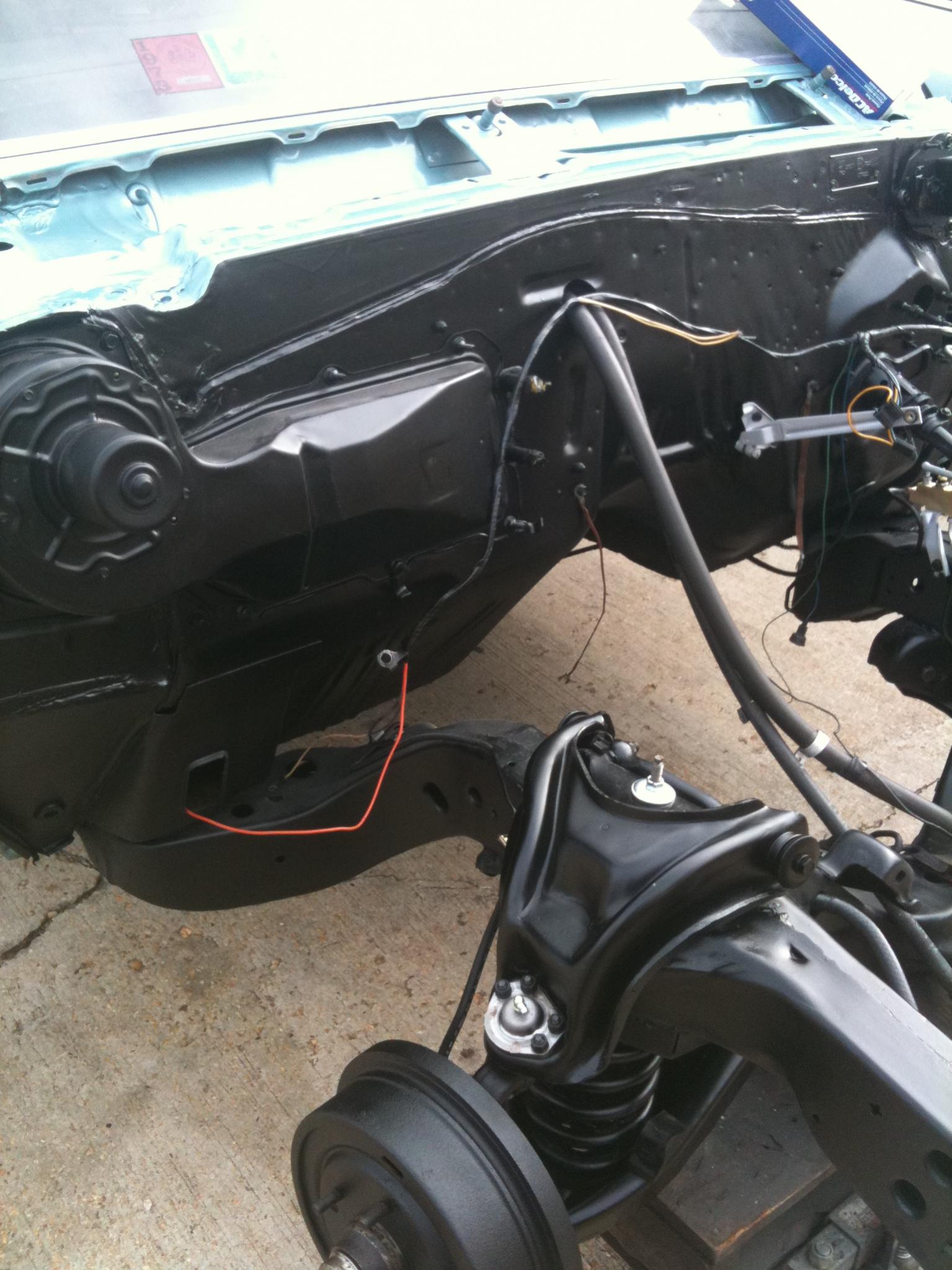

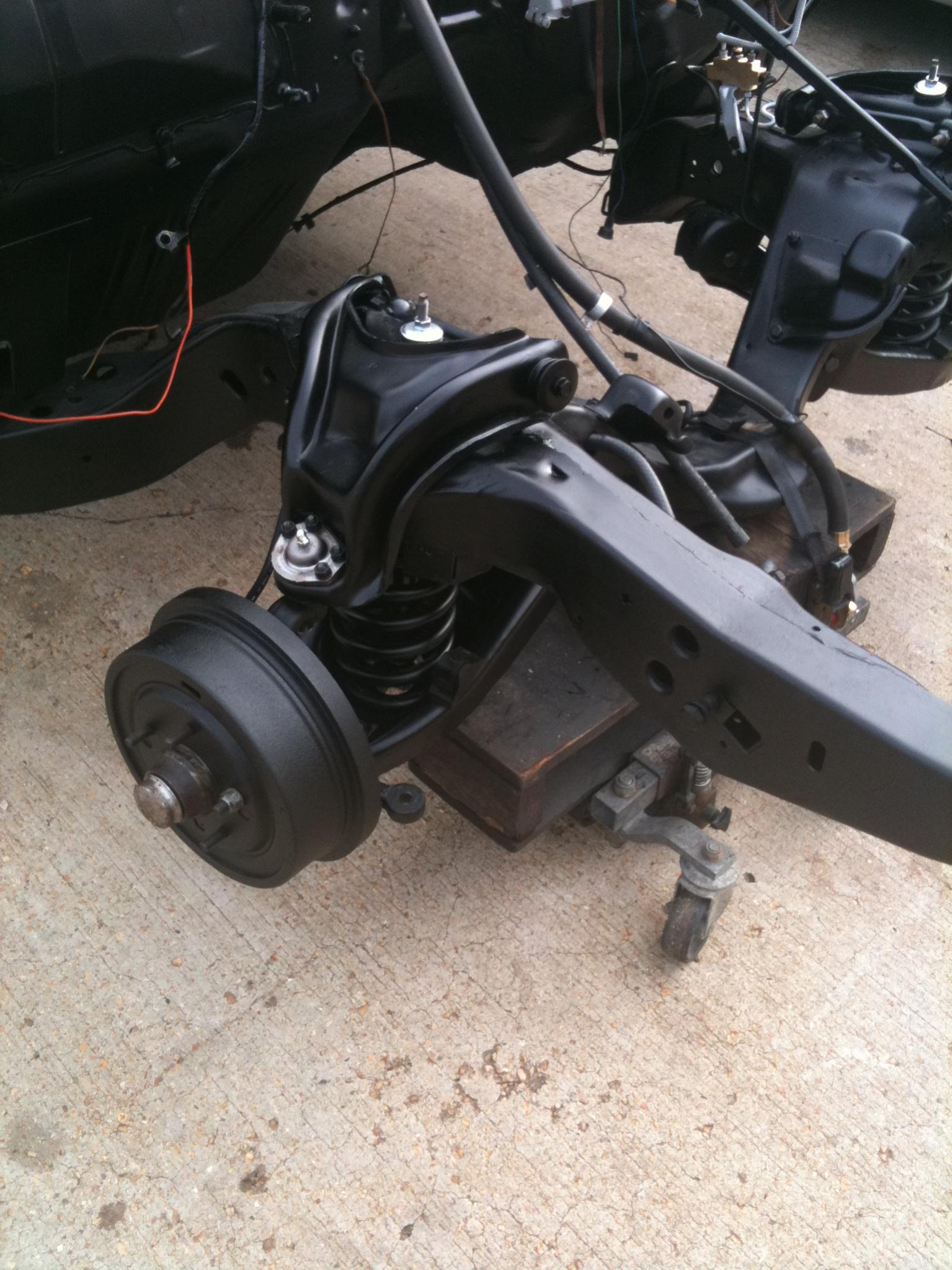

Most of the front suspension and brakes put back on.

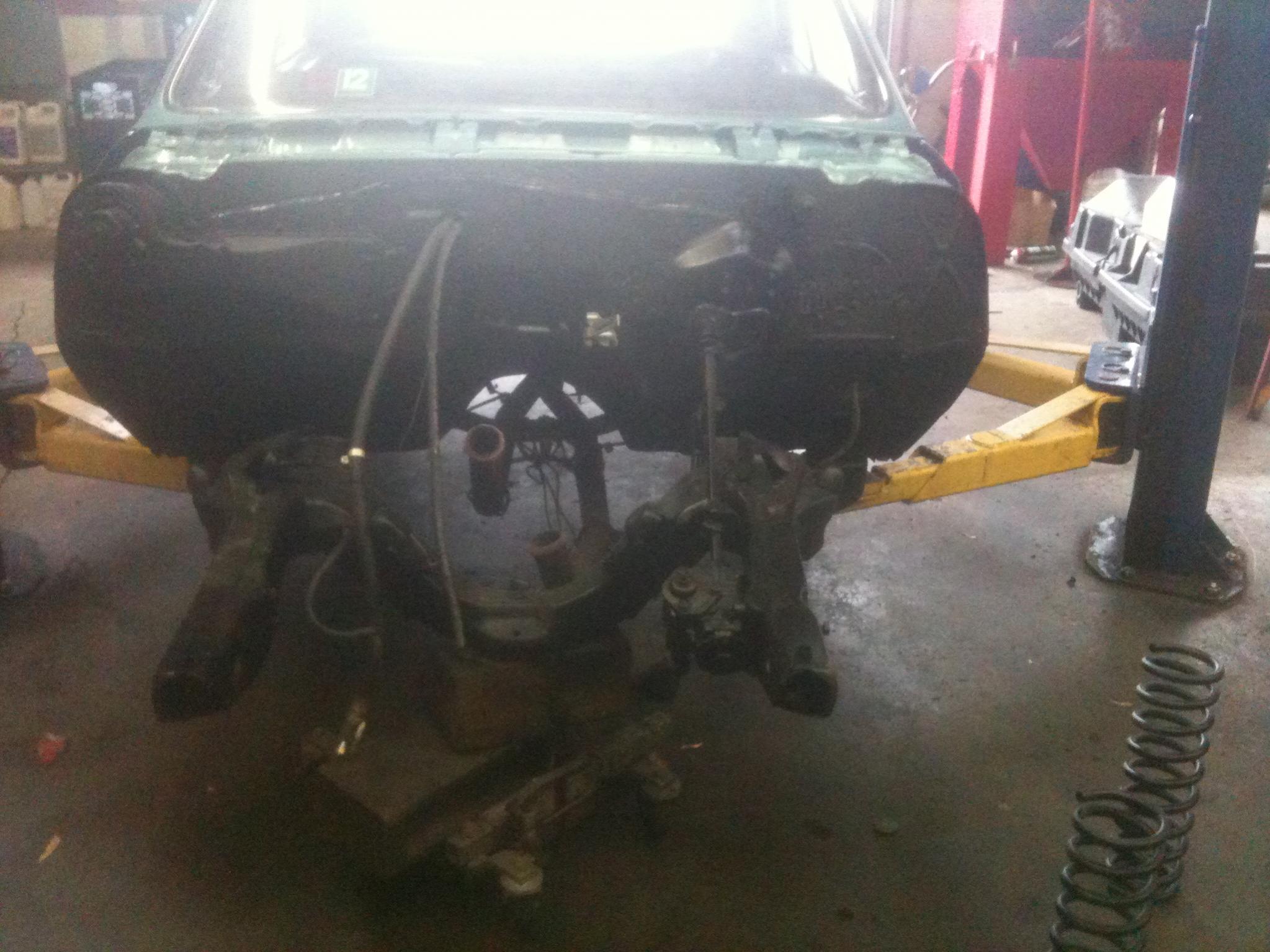

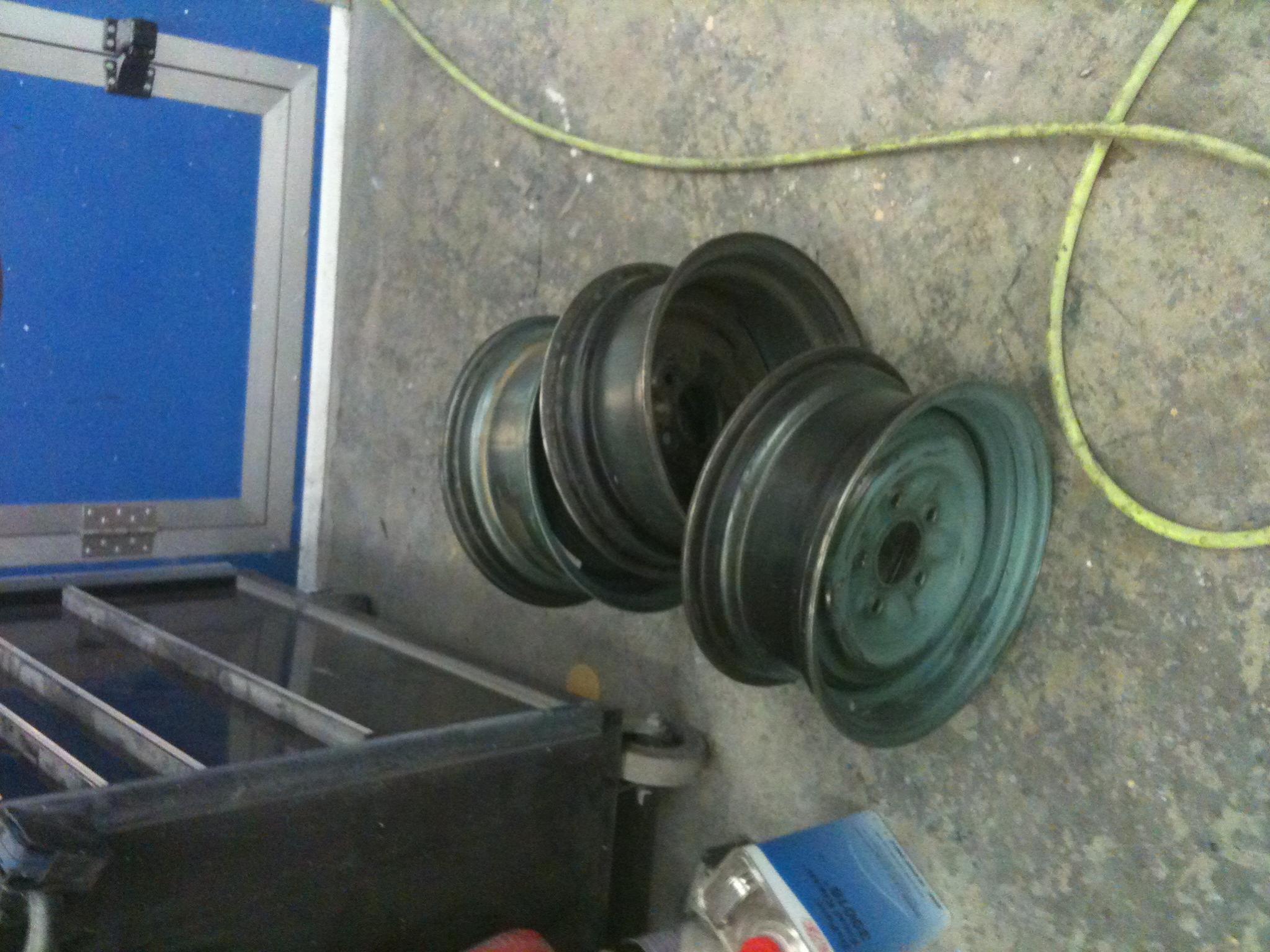

Wheel and tire before paint. 2 fronts were painted, redline tires mounted and balanced, then installed on the rear. 3 remaining wheels at the body shop to be painted inside and out. As soon as we have 4 wheels on it the engine will be painted the installed.

Old Nov 30, 2011 | 8:47 PM
MDTAHOE's Avatar
Professional Mechanic
Joined: Nov 2008
Posts: 2,950
Likes: 5
From: Bowie, MD

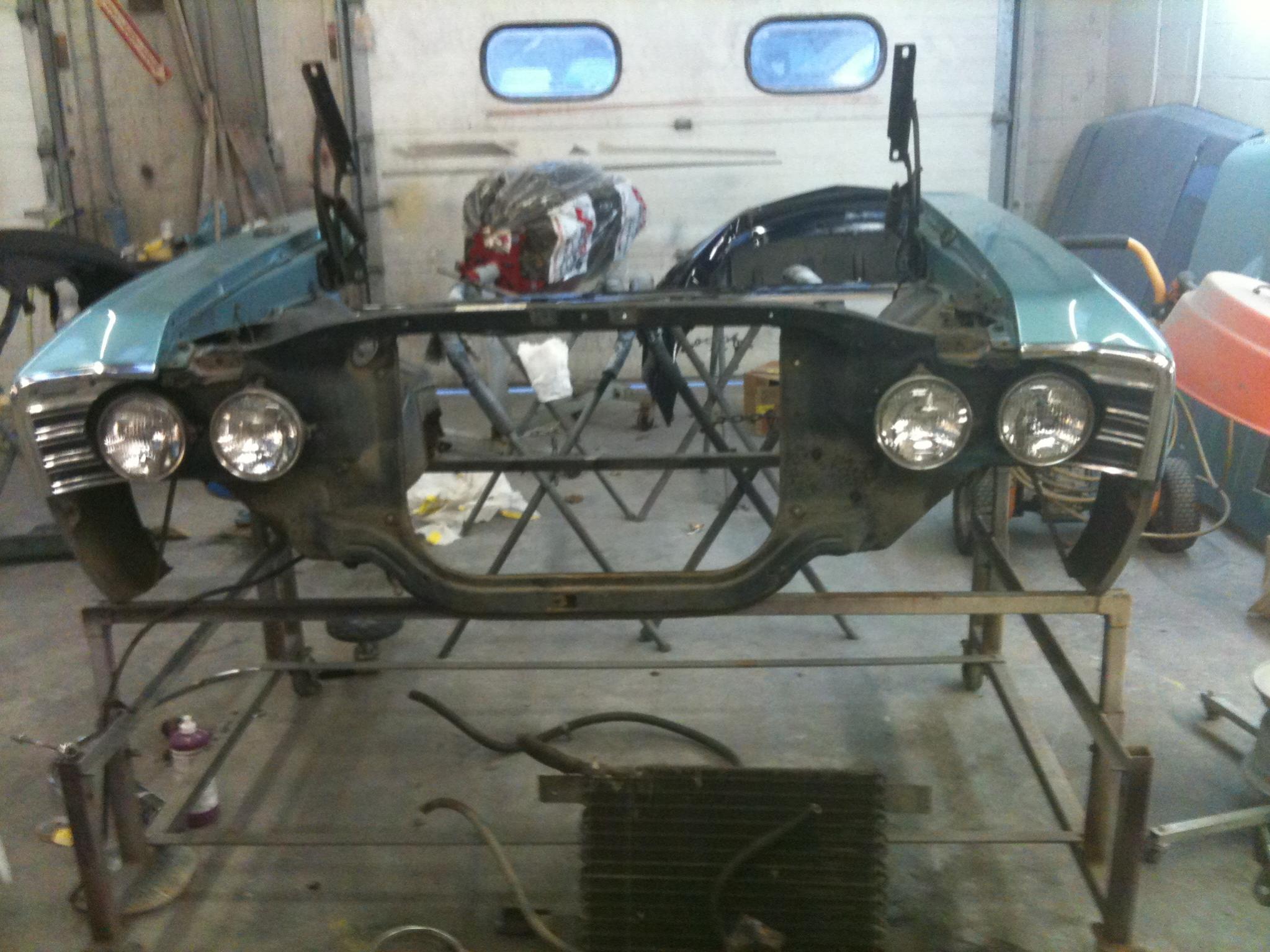

Remaining three wheels ready for paint. Engine at bodyshop to be painted. Front clip getting cleaned up ready for paint on the inside.

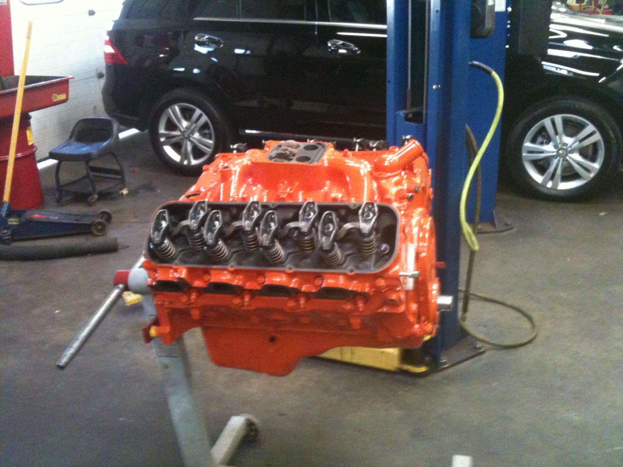

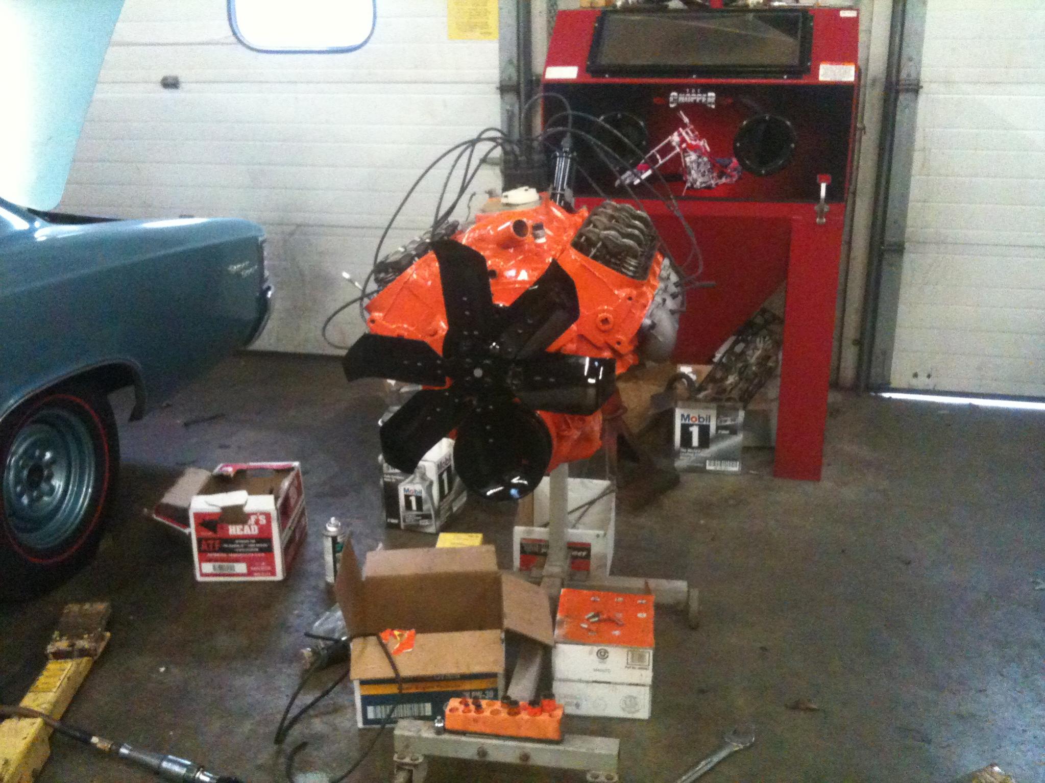

Engine back from body shop. I think color maybe of slightly but it will still look good.

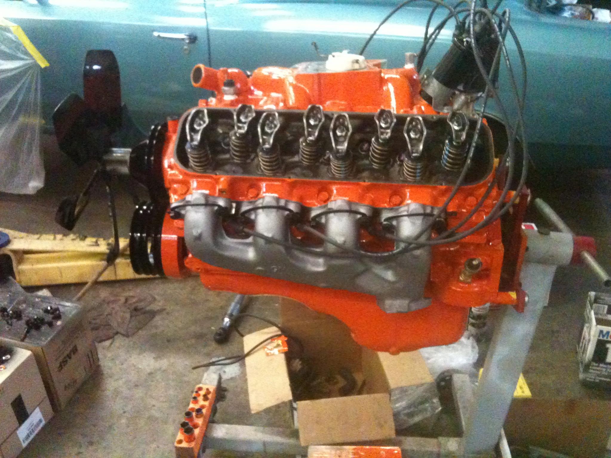

Engine back in
