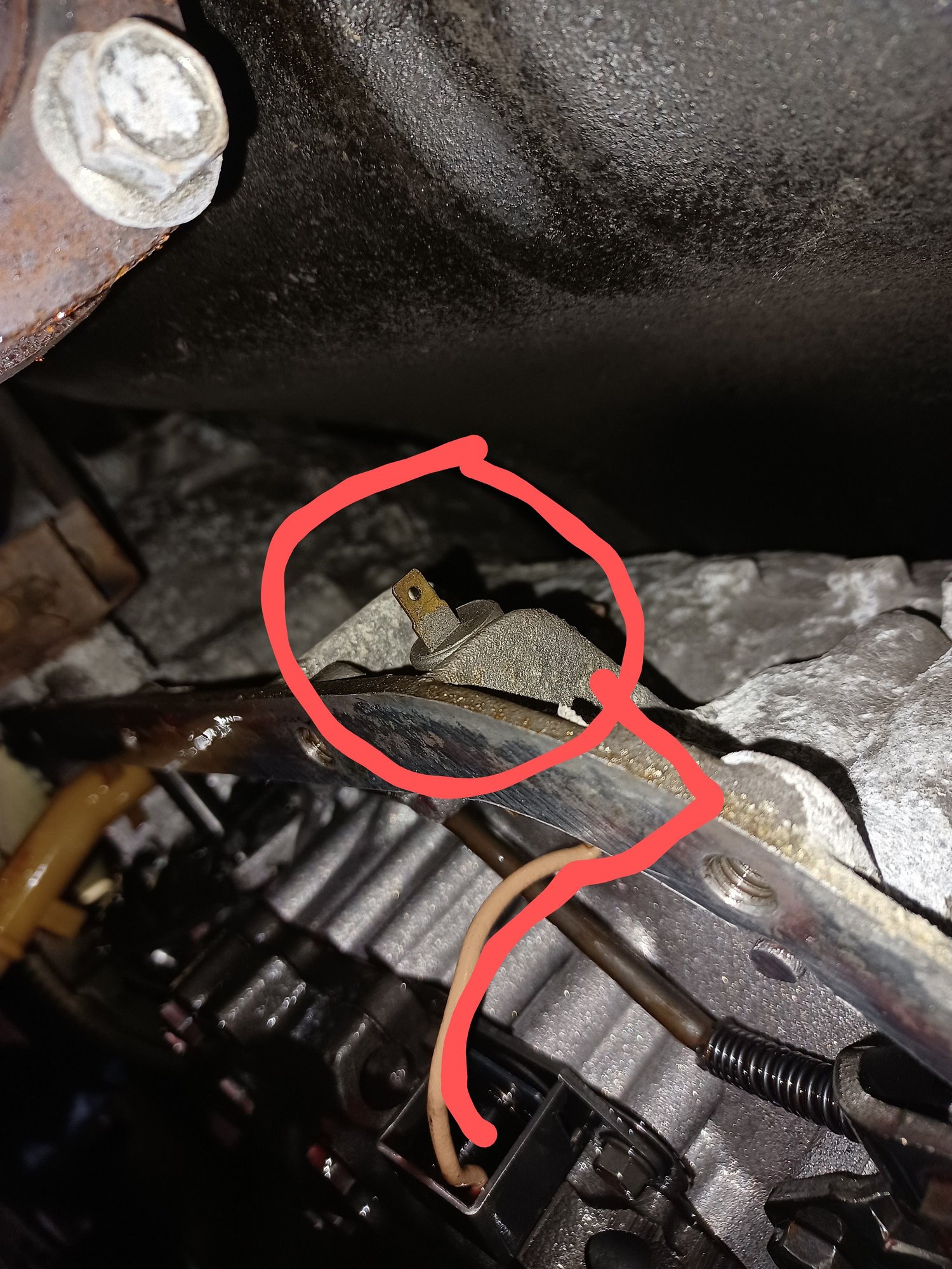

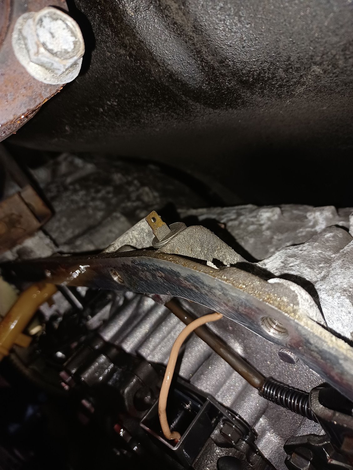

Dropped the pan took out the governor , seems to be in working order springs weights and value . Replaced ghe filter , notice one of the value body bolts was not tight so torqued down all bolts to spec installed pan with fluid but have not test drove yet . I did notice this electric connection was missing ... I'm guessing it's for the electric kickdown ??? But have no clue where wire is , there is a connection on the gas pedal I'm guessing for kickdown
Missing connection
Old Apr 25, 2022 | 9:03 PM
Posts: 11,340
Like you said, I would suspect that the electrical connection is for the kick-down switch located up by the accelerator pedal. Is there a wire connected to that switch?

I've not seen an electric operated kick down, or at least not in modern times. That could be your issue with it not hooked up, not allowing it to shift into hi.

Now that I've thought about it, I'm not sure the kickdown switch would really have any effect on shifting into third gear. It's purpose was to downshift when you floored the accelerator.
