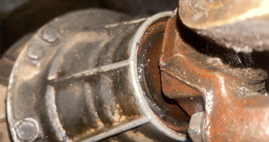

Default 1978 GMC SIERRA GRANDE 4x4
Hey I know this ain’t for trucks but i’m getting kinda desperate. My drive shaft the yoke will not come out so I can replace the shift shaft seal on which is leaking and not sure what to do about it have put both in neutral and doesn’t even budge a bit.
Old Jun 14, 2021 | 6:41 PM
kevinkpk's Avatar
Joined: Jul 2011
Posts: 5,920
Likes: 140
From: kevinkpk
Large pry bar, and maybe heat.
