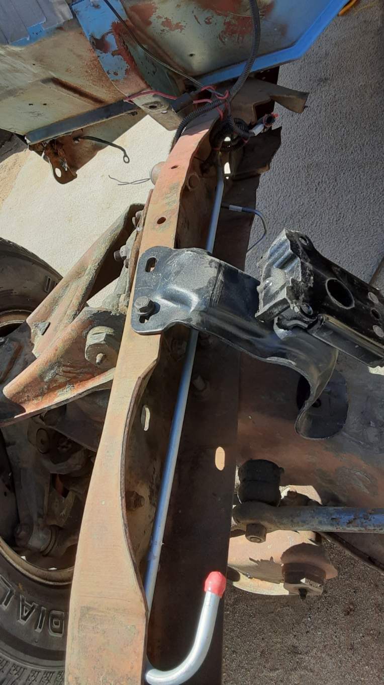

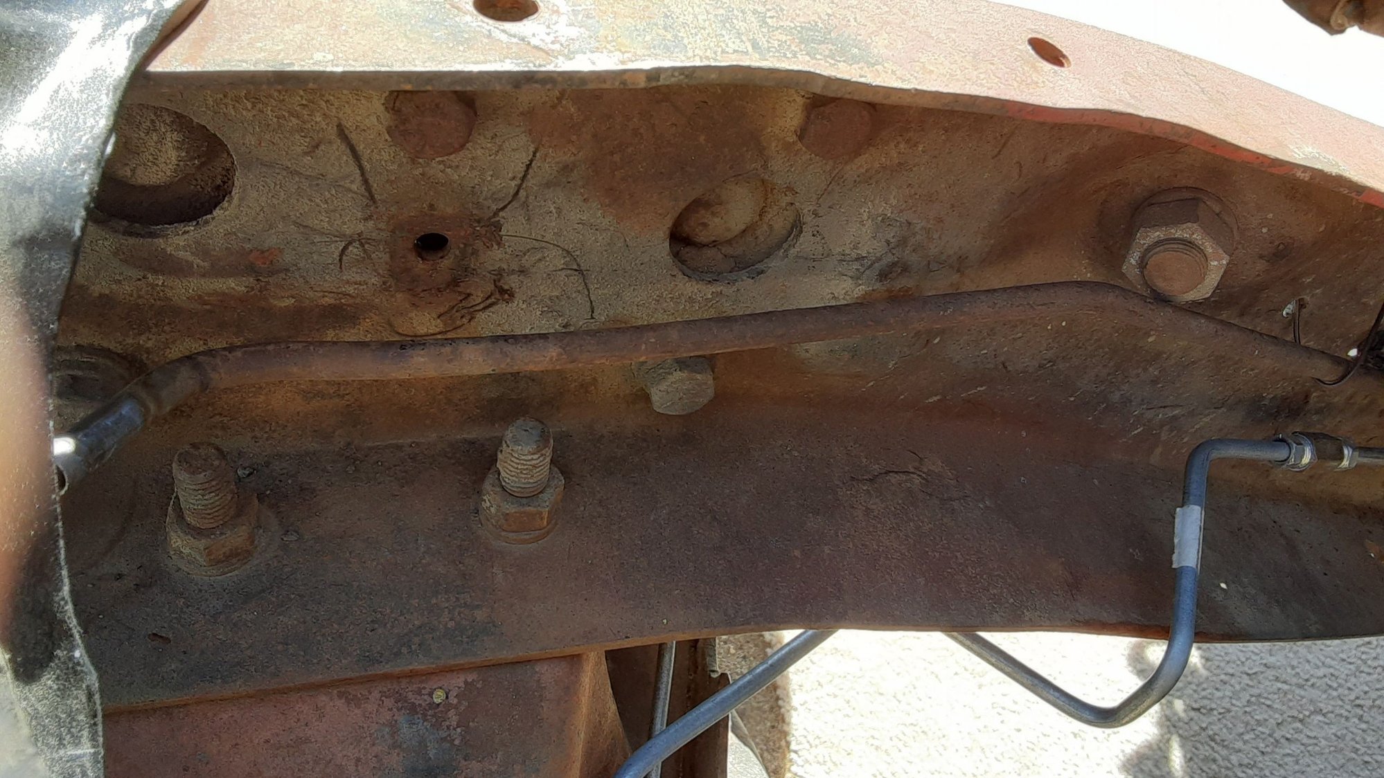

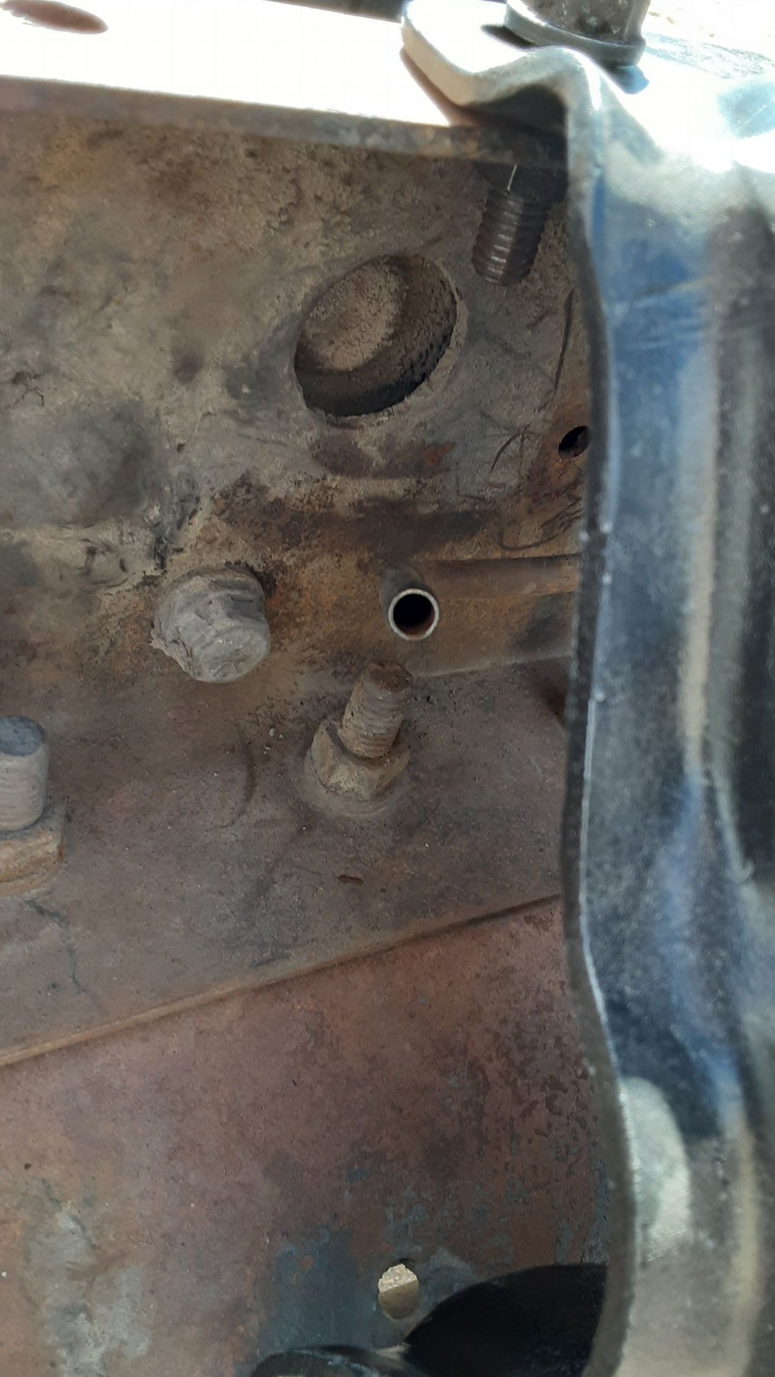

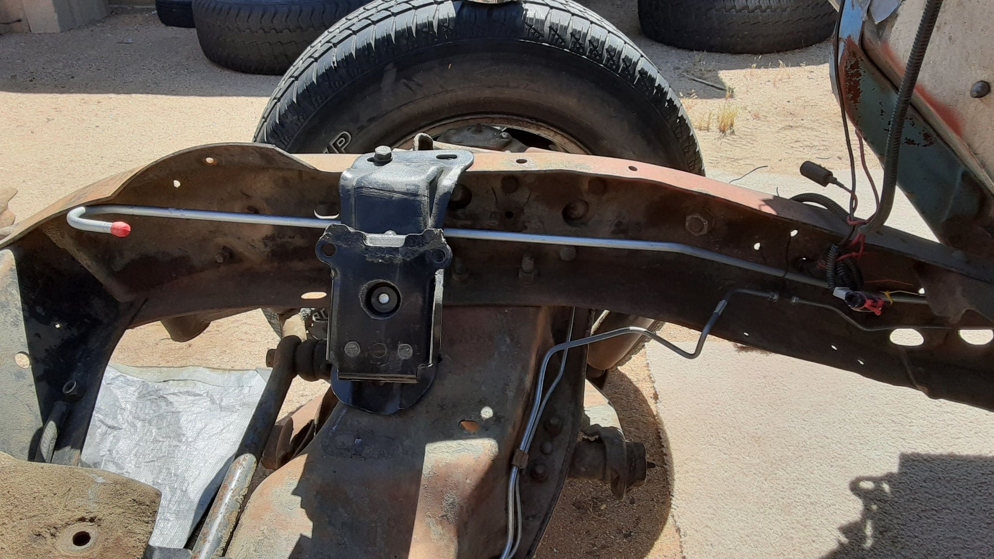

Here is some more pictures showing the engine area with the 3/8" line not really lining up with the curvature of the frame. Also showing the original 5/16" line (the dirty one) in how it ends up right behind the engine perch and motor mount making to pretty hard to service, as what I have found that small block motors can use the 6 cyl line but as you can see the 6 cyl line doesn't work with the V8 engine perch's but when the 6 cyl engine perch's would have been in place they would be about 2" back in the frame mounting holes but with the V8 engine perch's in there proper mounting forward holes they block the 6 cyl line making it hard to service. Don't remember where I read that 6 cyl lines can be used for small block motors but I will try to find it again too report the findings.
