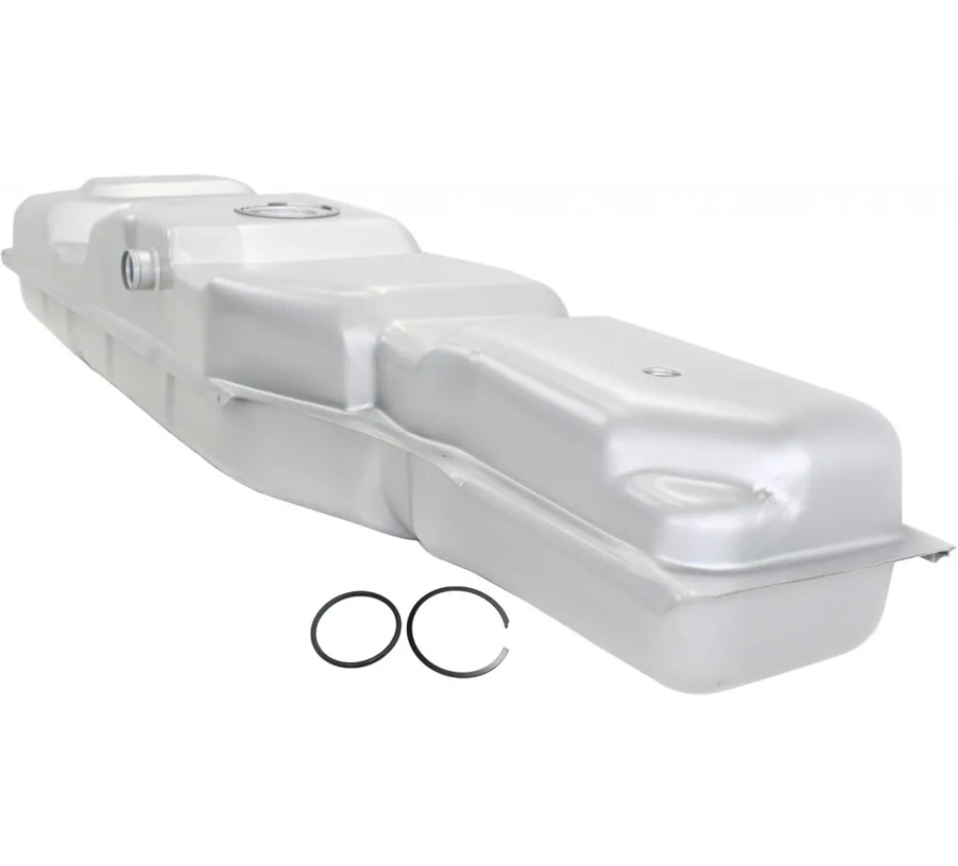

P.s. my ('97) tank is metal. The plastic that you see from below is just a cover:
Maybe later models had plastic tanks.

I think this Express 2500 has a metal tank. I was poking around looking for the filter and did notice what I thought was a plastic cover. Here's what a replacement tank looks like:
