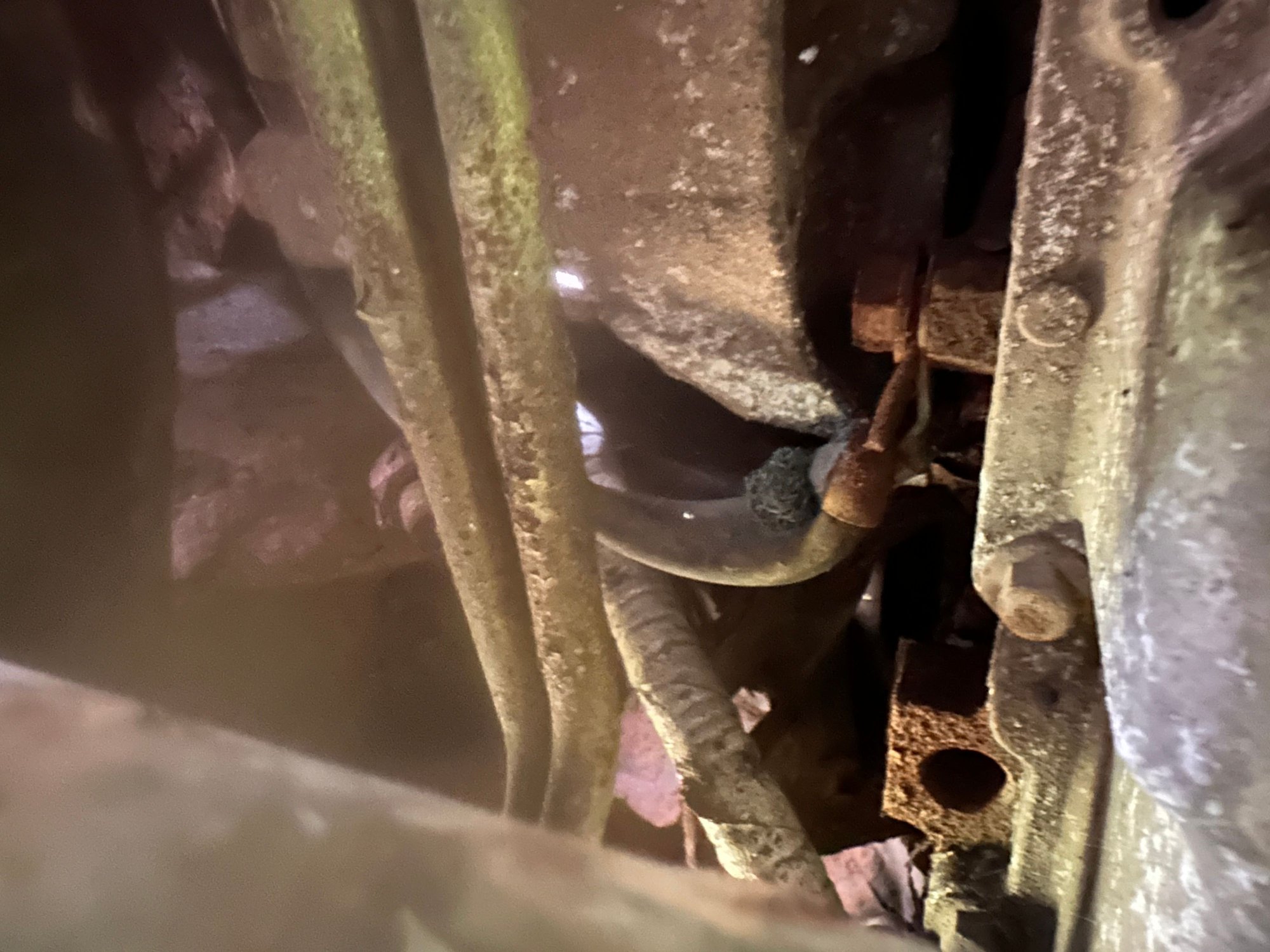

i watched this video and the mesh ground wire is totally missing from my van

Jeremiah Couloute's Avatar
Joined: May 2021
Posts: 8
From: ct
