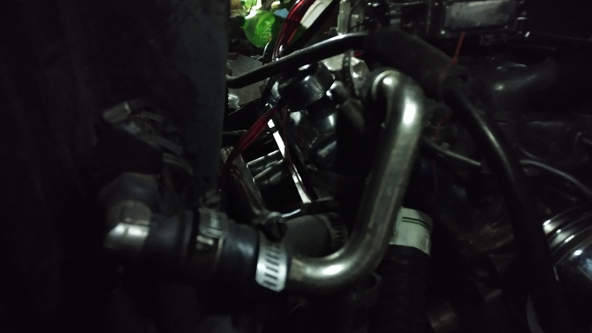

There is. It's a vacuum control 3 way valve on top heater hose. Very prone to internal breakage. I put a brass thumb valve on mine to simplify it and need no heat most of the year. You can just put one in top hose that runs to back if needed

hard to see in pic...where exactly. What year and engine is this pic from?

his engine looks pretty old....not a 2013 probably not even in the mid 2000's...Is that a carb and distributor in the pic
