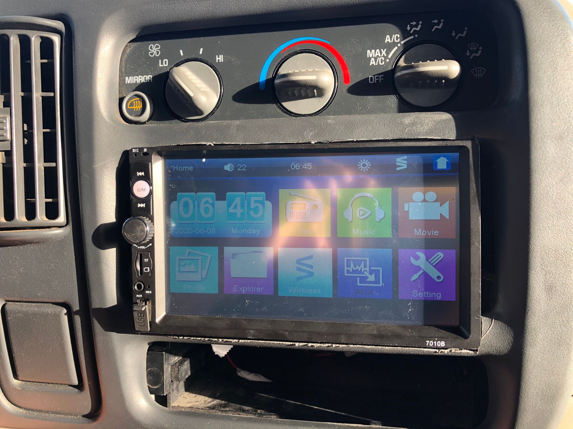

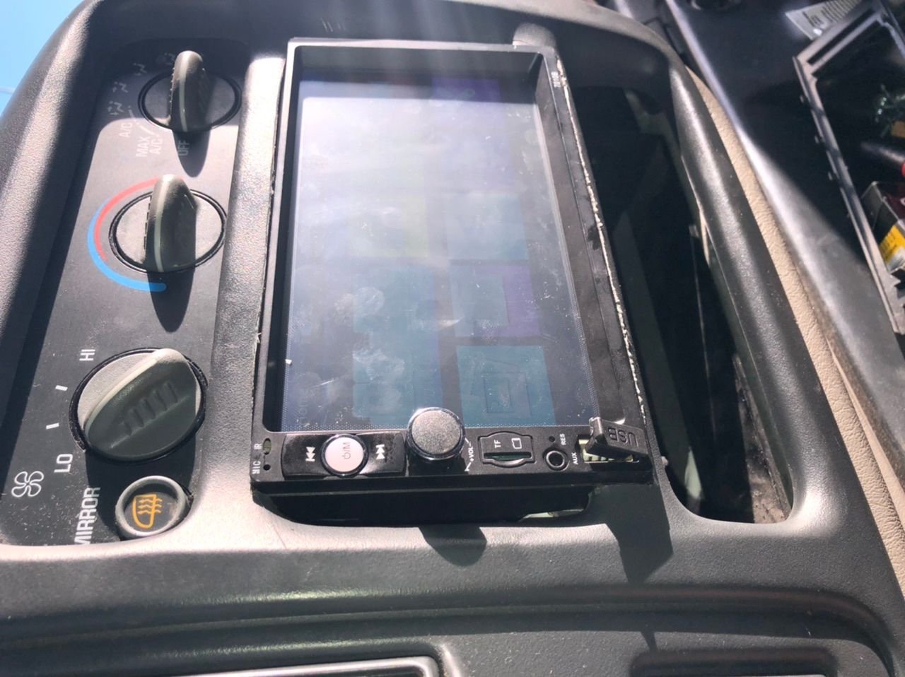

Decided to start cutting today. I installed a cheap eBay 2Din that has great sound actually.
The install looks ok and was a bit involved.

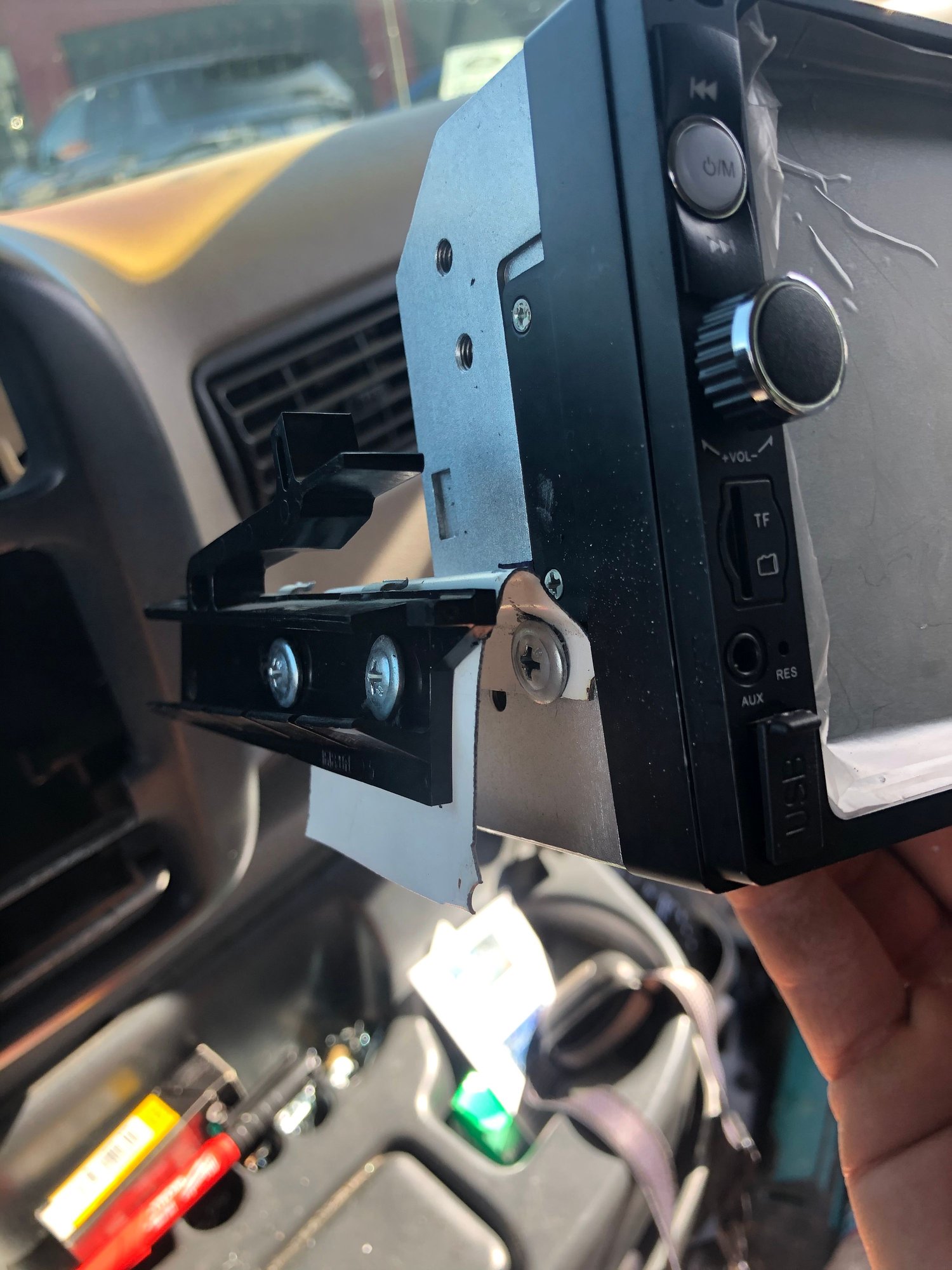

Key was to correctly align and measure depth before screwing in the brackets. I reused the brackets that let you pop put the unit easily, and fabricated some brackets/shims out of sheet metal to make it fit.
Used a multi tool to cut the dash, not a very tight fit around the opening but will get some trim that will finish it up nicely.
good luck
Also gotta find a pocket/cover for where the CD player was
