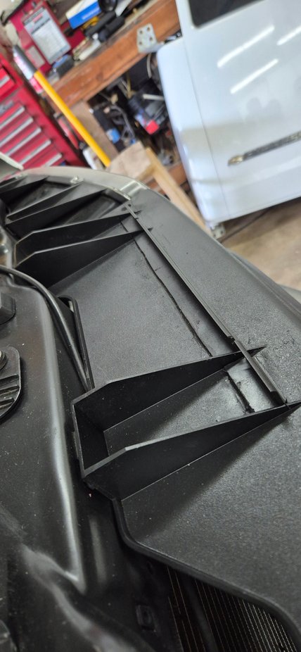

It seems like Chevy designed the plastic front grill with the exact angle at which nuts, bolts or tools will eventually slide off but a human looks at it and still wants to set stuff there. LOL.

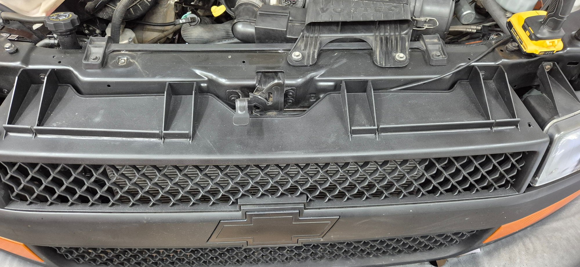

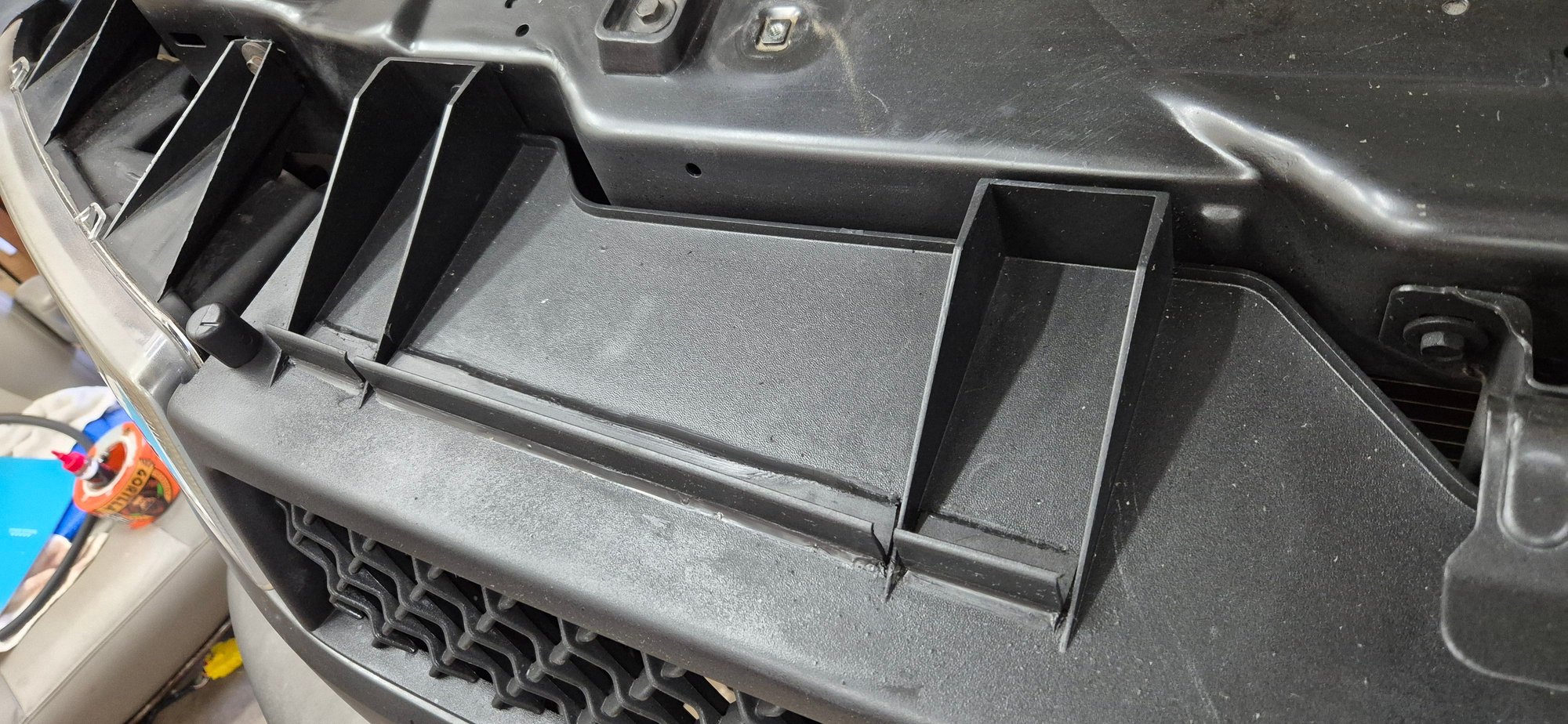

I took some plastic angle and turned the gussets into small parts trays. Now I can put nuts, bolts, reservoir caps, phone and tools right there while I'm working and even keep them somewhat organized.l
I've been wanting to do this since I got the van and finally got around to it. Seriously GM, how much would it have cost to mold the parts like this at the factory?
I sliced up a larger piece of plastic that had a nice angle on it and used that material. Any sort of angle material would work. I just held it with some silicone construction adhesive which I use regularly and know is very strong. You could also just use some small screws through the plastic too. There's nothing behind there to hit.
I left enough space between my pieces and the gussets so that any water or fluid can drain off and not puddle. I lined them up with each other and left them higher than the end of the gussets so I could rest something long there if need be.
