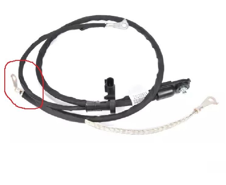

did you see the battery current sensor on the negative wire ? it doesnt fit both my wires only what did you do ? how is it working ?

im trying to remove my ground wire to replace it . the ground wire is one continuous wired connection in series, which goes thru a battery current sensor before attaching to battery . im having a hard time accessing one particular bolt on the motor its very hard to get to and i cant figure out how to access . the reason why i don't just run a different wire is because the current sensor will not be able to read and gauge if it not going the the battery current sensor

I would think any bolt on the motor will work - is there one easier to hook to?

awesome idea , trying figure out best way . as long as the end goes thru the battery current sensor located about 12inches from battery post i should be good .
the reason im changing this is because im upgrading my alternator 255amp and i need thicker gauge all way thru the ground system . so i plan to so this with 0/1 awg all way thru front to back if i can and to the frame and fender .
need the extra amps for music and lights .

Seriously though, you could ground anywhere on the frame. Either to an existing bolt or drill and tap a new hole somewhere. You could always run a new current sensor / gauge too, particularly since you're planning on increasing the draw quite a bit.
