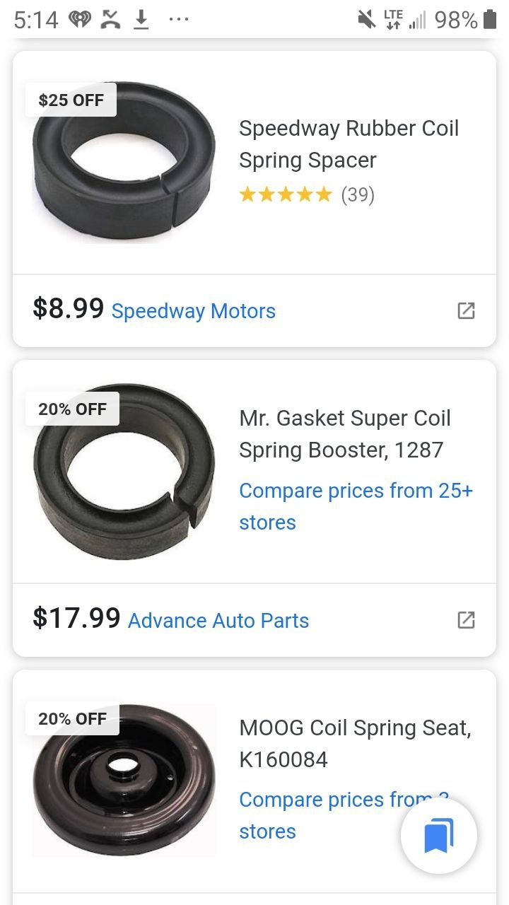

When I got my conversion van I thought it was normal. But I believe part of the process is putting cushy springs on it. My 92 was made even less responsive by being converted into a handicap van with the heavy lift.
trying to solve this problem I noticed front springs were thicker than a burb or pickup and most spring stiffening hardware would not fit so I got some poly bushings put one inside and one out with 3/8 bolt an 2 washers to squeeze it together between coils.

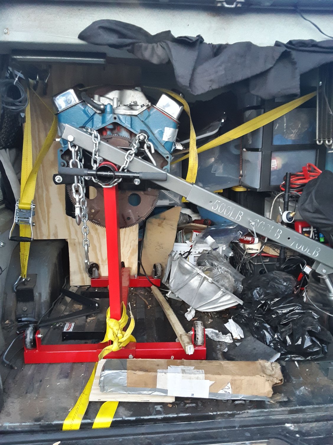

There are other ways to get the rebouncy out. I use 2 old shock bushings and a 3/8 in bolt to sqeeze them between the springs
And dont forget any set of leaf springs at junkyard that is 56.5 x 2 inches shoul fit.make sure you grind sharp edges off the tips or use teflon or poly/graphit buttons. With engine,crane ,stand and tools my vandura doesnt even sqat. Springs are from 1 ton 70s k model 4x4
