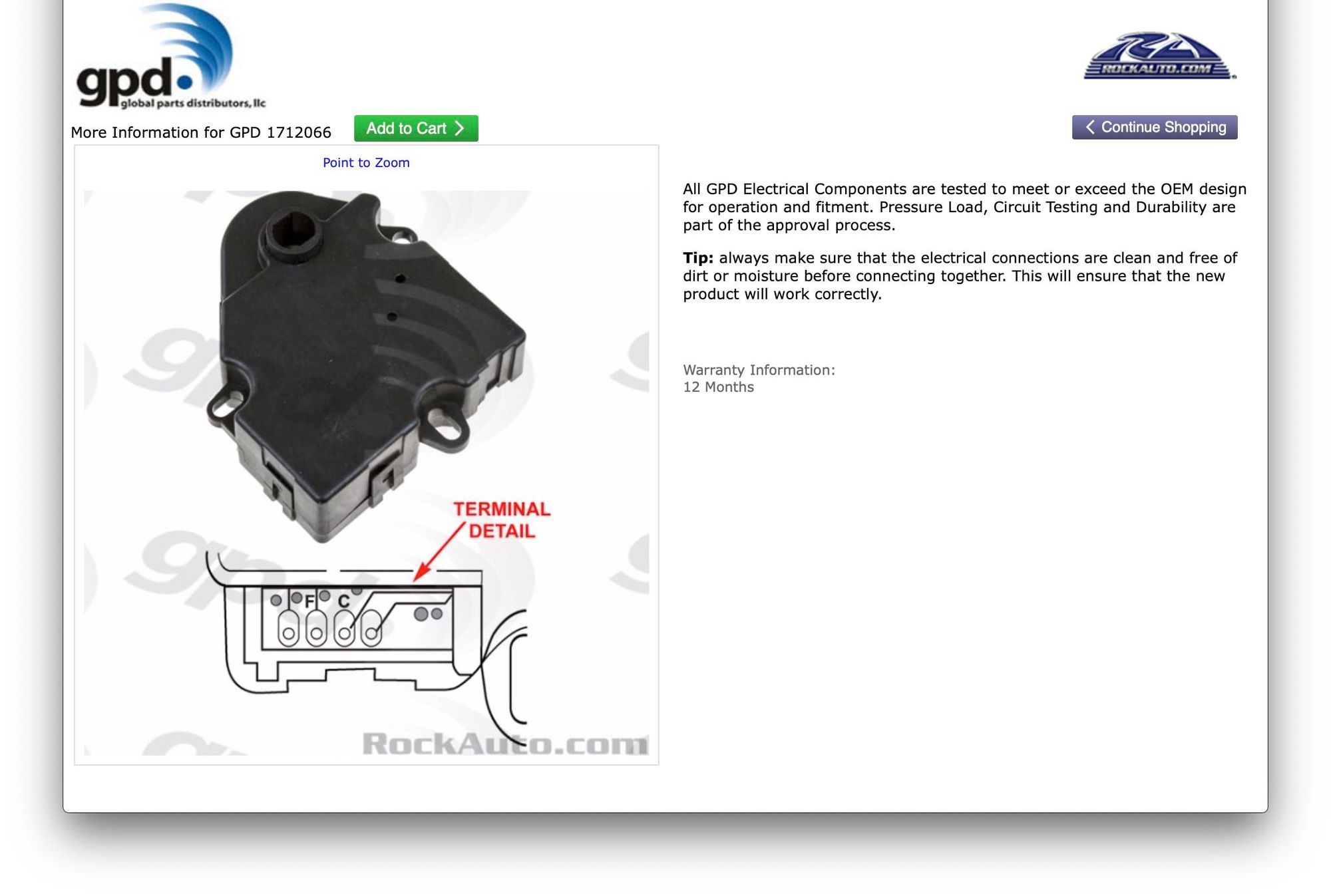

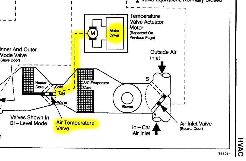

Look closer
This is a replacement part.
In auto, vacuum is used for things that need to be open or shut. How do you get vacuum to open something part way? The temperature dial is continuous.
Old Dec 28, 2018 | 10:51 PM
from GM ...
2005 GMC Truck Savana
Air Temperature Description and Operation
HVAC CONTROL COMPONENTS
Air Temperature Actuator The air temperature actuator and auxiliary air temperature actuator are a 3 wire bi-directional electric motor. Ignition 3 voltage, ground and control circuits enable the actuator to operate. The control circuit uses a 0-12 volt linear-ramped signal to command the actuator movement. The 0 and 12 volt control values represent the opposite limits of the actuator range of motion. The values in between 0 and 12 volts correspond to the positions between the limits.When the HVAC control assembly sets a commanded, or targeted, value, the control signal is set to a value between 0-12 volts. The actuator shaft rotates until the commanded position is reached. The module will maintain the control value until a new commanded value is needed.
