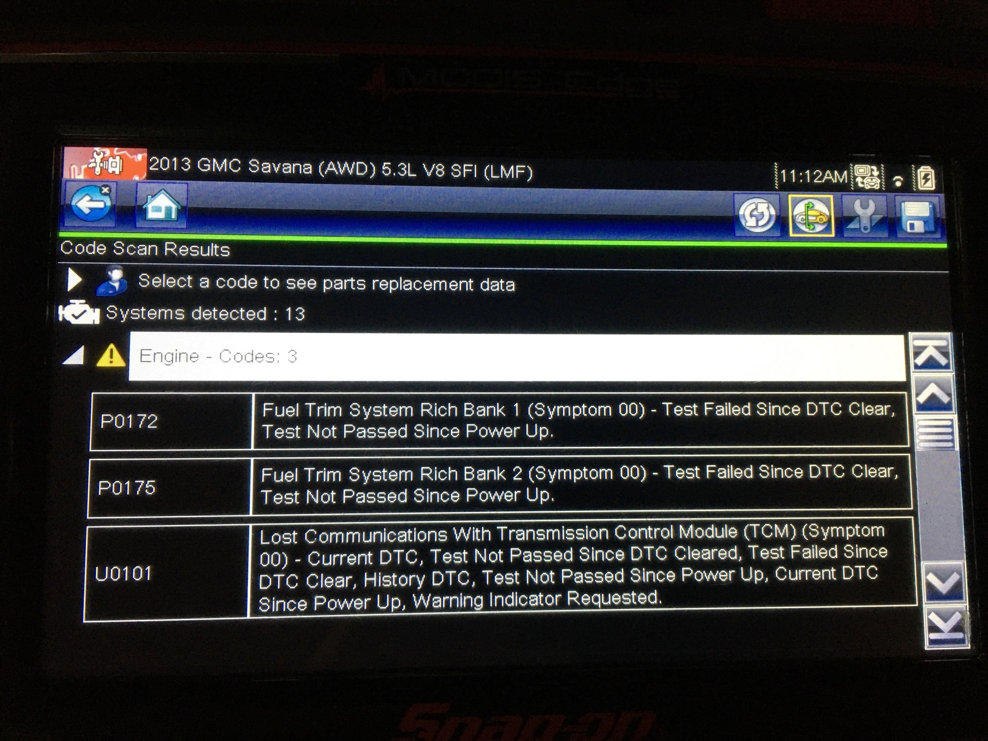

none that my Scanguage can read

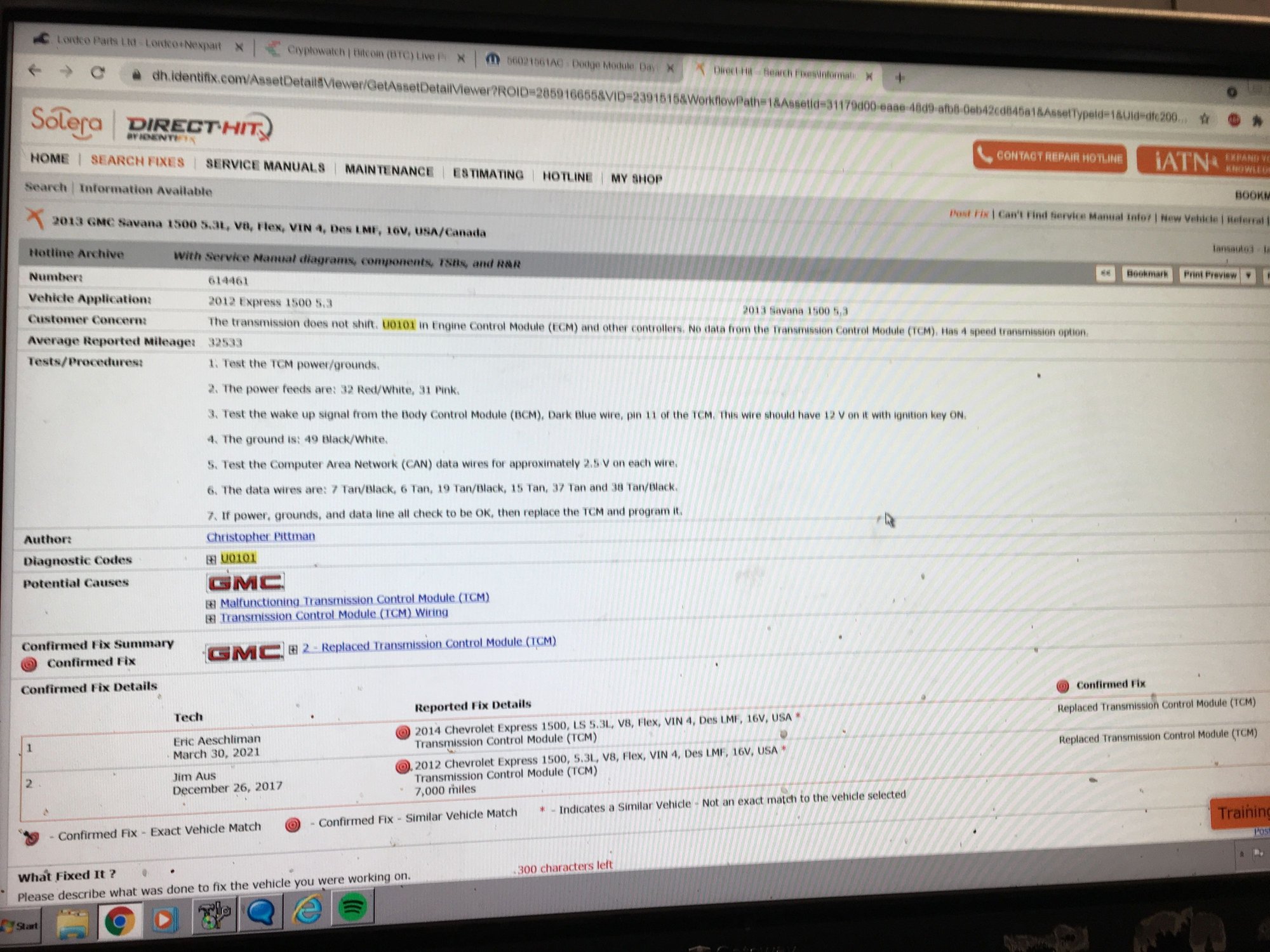

I took the van to a general mechanic today, where they ran a diagnostic scan. The transmission control module isn't responding. There's a problem with the module, or the wiring.
They sent me to a transmission specialist. The transmission guy said it was an electrical problem, and referred me to a auto electrical specialist. I have an appointment there next week.
If anybody has pin-outs or diagrams for the tranny & TCM on a 2013 1500 that would be most helpful. This weekend I'll get out the multi meter and start checking for power, ground, and continuity on the other circuits. I'm starting to sweat a bit because I'm moving to the next province (1,100km through the mountains, towing a trailer) in about a week.

U0101 Lost communications with Transmission Control Module (TCM)

Unless you think you're able to trace the fault to the TCM, might also do like we did with my electrical short. I don't know if you have removed the doghouse, but it has to be removed, along with the passenger seat. Then plug in your scanner, key on the engine off, start giggling the bundles of wires in the engine harness, looking for rubbing wires on brackets on top of the engine. The scanner will react when a break in a wire touches again, then narrow it down to a certain bundle and find the break. Like in the third picture, good luck.
