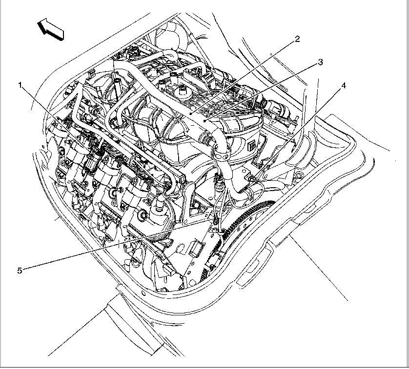

Thanks. Does your source describe the location of G103?

From: Quebec, Canada
For a 2009 it is item no 5 under the engine cover.
