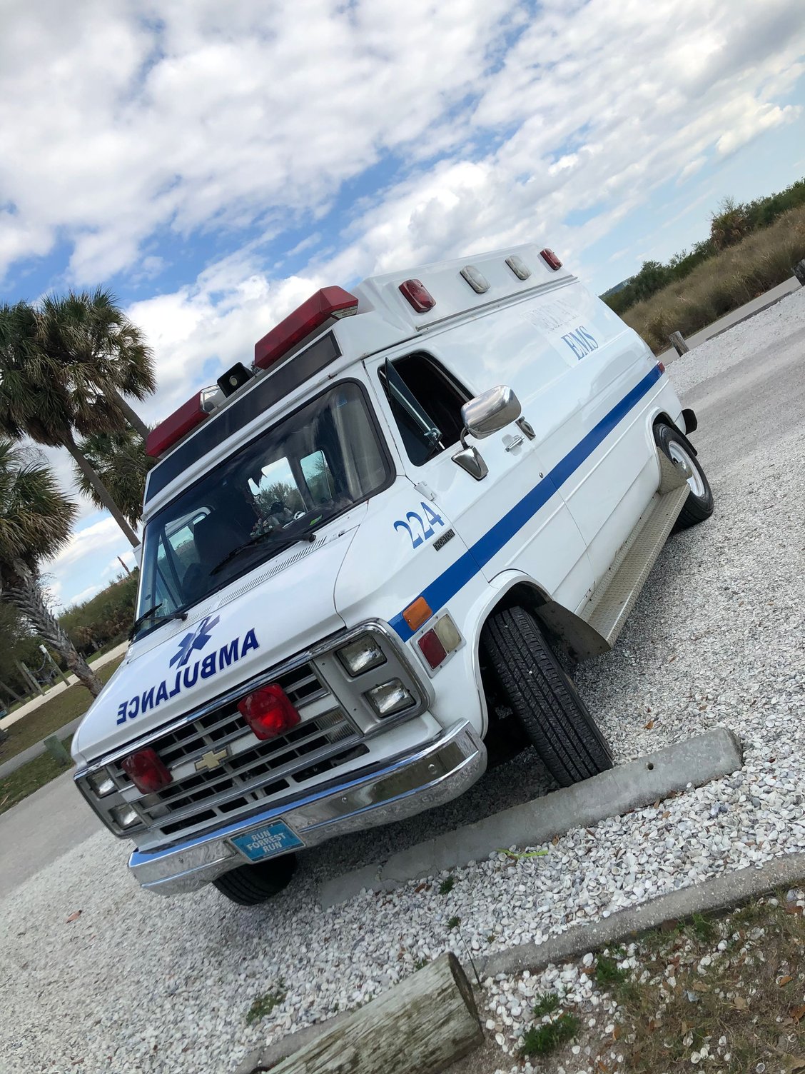

Hi there, my name is Logan, I have an 86 g30 ambulance van with a 350 and I’m having this issue that keeps coming back where I lose power under load/while accelerating, almost like it’s stalling. Starts fine, idles fine.. I’ve replaced plugs, wires, distributor, fuel pump and filter.. no matter what, I drive a few hours and it’s happening again. My girlfriend and I travel/live in the van, so there’s a bit of urgency to fixing this issue, please help! Thanks in advance!
