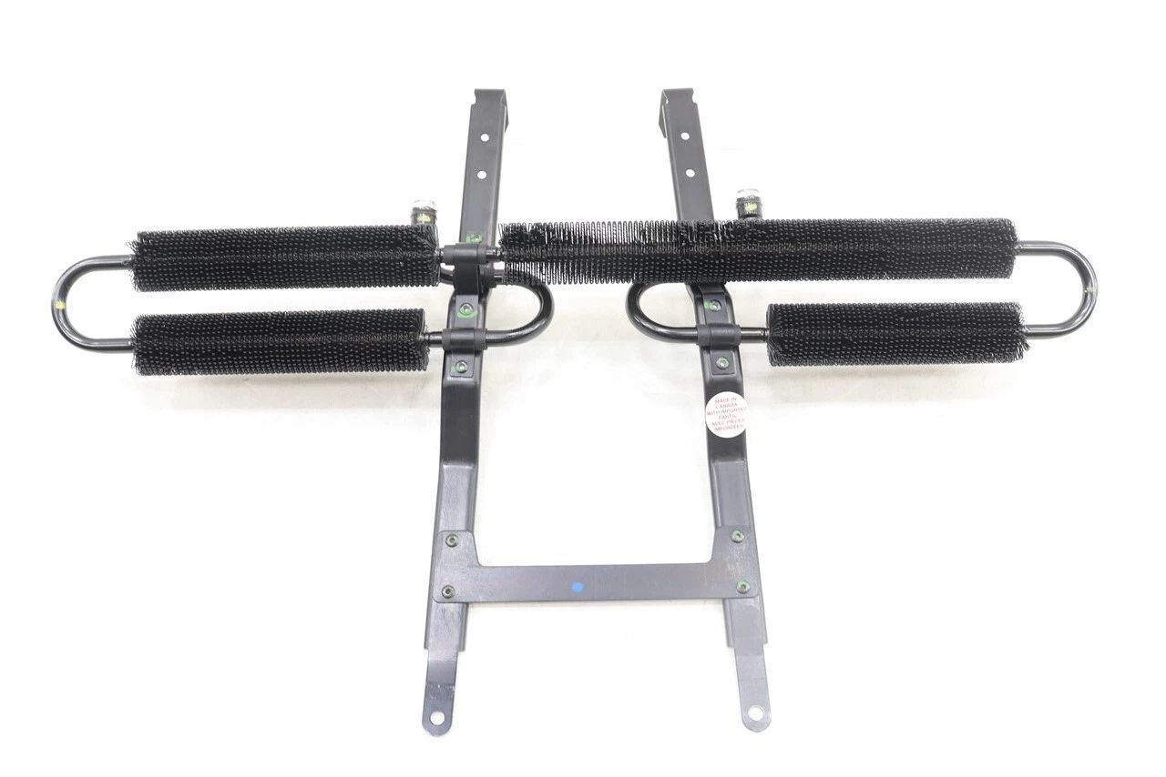

On the subject of transmission coolers. I have a 2016 3500 6.0L with 6L90 transmission.
As for transmission coolers, mine has this thing. Part 22839313. Did they ever install something beefier than this from the factory (whether with z82 package or not?) For my model year, 2016, this was all that was available - Z82 towing pkg did not include upgraded cooling.
For towing a fairly heavy trailer (7700lbs) should I upgrade? Or is this probably enough? Monitor the trans fluid temp and see how it does? I've not had any issues towing in hills but haven't gone over any big extended mountain passes just yet.

From what I understand that is the beefier option. Mine only has one row of fins not 2. Like this. https://www.rockauto.com/en/moreinfo...308860&pt=2088

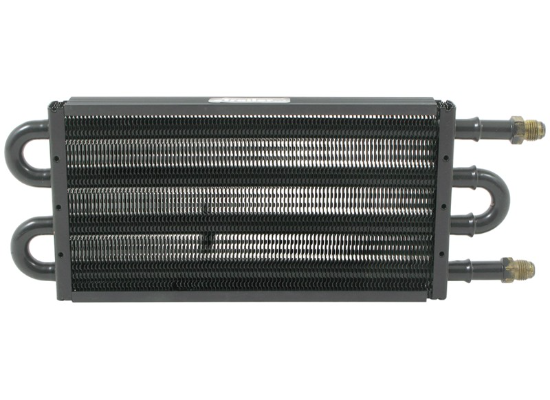

I guess what I'm asking is, what is the actual capacity of this thing, at what point do I need to upgrade to something aftermarket like a Mishimoto? I don't want to burn up my transmission but spending hundreds of dollars on an aftermarket cooler that's not necessary isn't really my desire either.
The factory cooler looks like it could maybe keep pace with something like the below (link):
But nothing compared to some of the heavy duty stuff you can buy (40k coolers are massive).
I do like how the factory cooler looks so free flowing. Like it won't impede the air flow to the radiator very much. But again, I just don't want to toast my transmission.

I bet if you measured the length of tubes with fins on your cooler and that Derale, they would be about the same. I think that the HD Silverados had a bigger option that would bolt in the same spot. I don't tow (yet) but have been contemplating upgrading to the cooler you have when I do the fluid on the trans.

I've sean seriously powered upwards of 800HP at the drag stripe using the same cooler I have. matter of fact I have used this same hayden on every GM I have. you don't need a giant expensive cooler unless your towing uphill 10K LB load.
