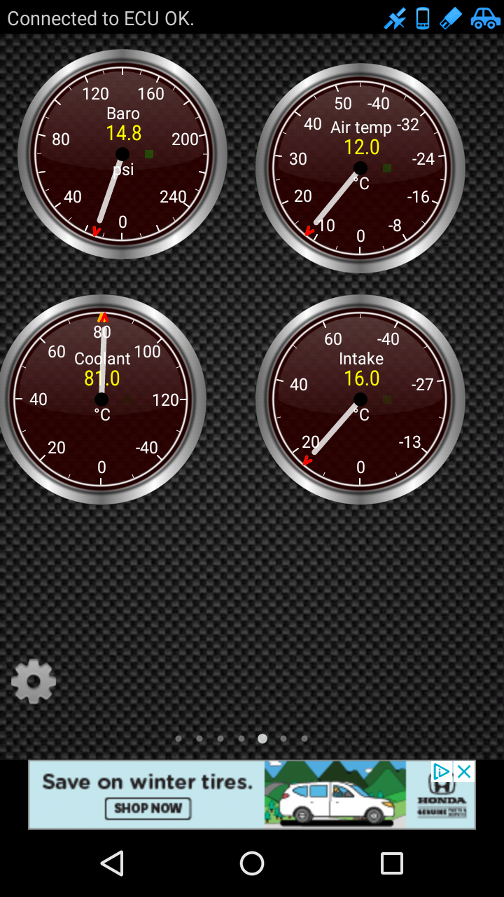

I remembered today that I had an OBD Bluetooth adapter stashed away. (Ordered it on eBay from China for a couple of bucks about a year ago) So I decided to give it a try and downloaded the Torque lite app. Pretty impressive I must say.
Sure enough, I pulled up a gauge for "Air temp", so I guess I have that sensor, even the van didn't come with any display for it . It's lower than the intake temp, but still higher than outside temp. (but again, this was idling in park). I'll have to poke around with a flashlight and see if I can spot the thermistor. Cool beans.

Originally Posted by Twscarp
Hi, here is my Torque display from today (2008 Express 1500 4.3l, 225K), the Air Temp and Intake are different, so it must have 2 sensors. I think my outside temp sensor is below the radiator somewhere, and assuming the Intake Air temp is on the intake ducting somewhere.
Hi, we talked about this in Post #19, last month.
Hi, I couldn't find a replacement sensor on my 4.3l, so I'm thinking the Intake Temperature Sensor is part of the MAF sensor.
