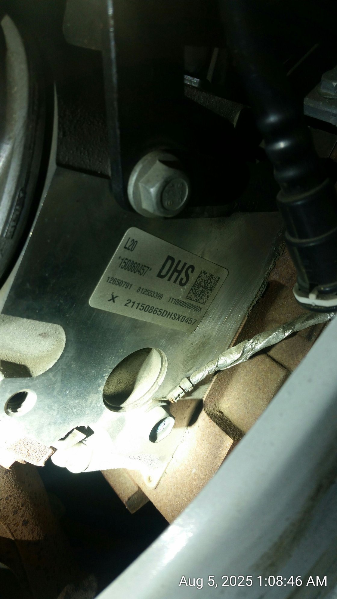

Anyways here is this sticker on the engine, Is it the L20 engine? what does the laser cut number with letters on the block mean? emailing chevy just gets me stone walled, telling me I need to go to stealership and pay
engine sticker

The RPO code is missing from the glove box or is covered up by PO with foam. There is no RPO code on the door frame, just a model number. The model doesn't turn anything up with a search. However that sticker on the engine under the dog house has a RPO code. It is L20, (look at pic and tell me if that is RPO code). When I run that CODE through a decoder SOMETHING DOES COME UP. This is what comes up L20
  • ENGINE,FLEXIBLE FUEL,(GAS/ETHANOL E85),8 CYL,4.8L,SFI IRON, GM
Thats all that comes up. Guessing that means it's flex fuel? Since nothing else showed up. Unless someone slapped that sticker on there, but I doubt that. IS it really normal for chevy to make a flex fuel vehicle and have NO YELLOW gas cap and NO badging? Come on chevy.... how you suppose to know for sure? I still can't find where the damn fuel lines go into the sensor, I guess I need to remove the dog house again to find that little sensor to triple check. I guess the worst case is I try some flex fuel at some point and it spits out a code, I have to drain the tank somehow.

Yeah I found that sticker. "Service parts IDENTIFICATION". It was on passenger side door. It contains a bunch of three letter RPO codes. One of the codes is L20. This is the RPO code for the engine I guess. I mean it checks out with the other sticker that was on the engine itself, under the dog house. That other vin site wasn't useful because it said that if the 8th letter of was "A" it was the L20 engine. This is not the case here because the 8th letter is "F" but the vehicle still has the L20 engine. Not sure why chevy makes things so confusing, if one of you guys could shed light on it, awesome. I really just love piece of mind when it comes to flex fuel as we all know, putting the wrong stuff in could damage the vehicle. Easy to do when things aren't clearly marked.

According to the RPO lookup site the L20 code is for a 4.8 liter Flex fuel engine.
