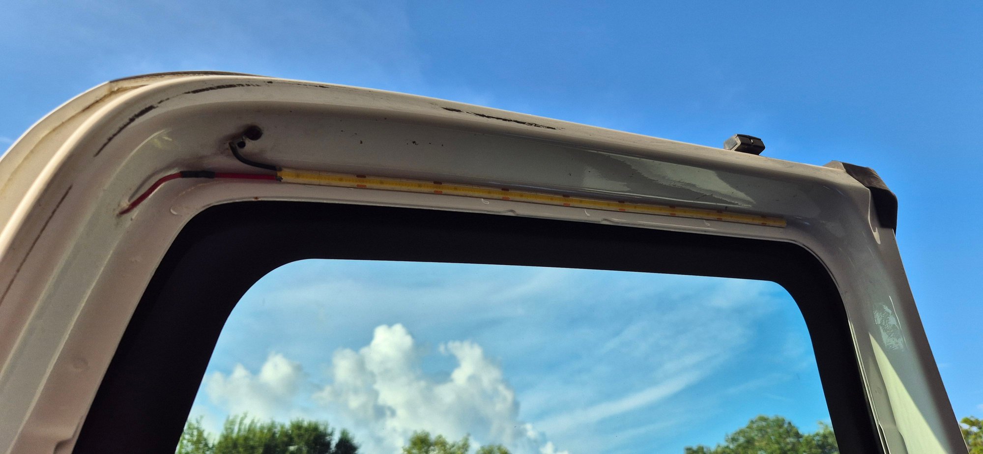

Another nice addition was the LED strips on the rear doors just above the window. They give a ton of light for hooking up a trailer or something like that behind the van and if you open the doors all the way they throw a ton of light behind the van and light up the whole area. Makes a big difference when you're trying to pack out after dark.
