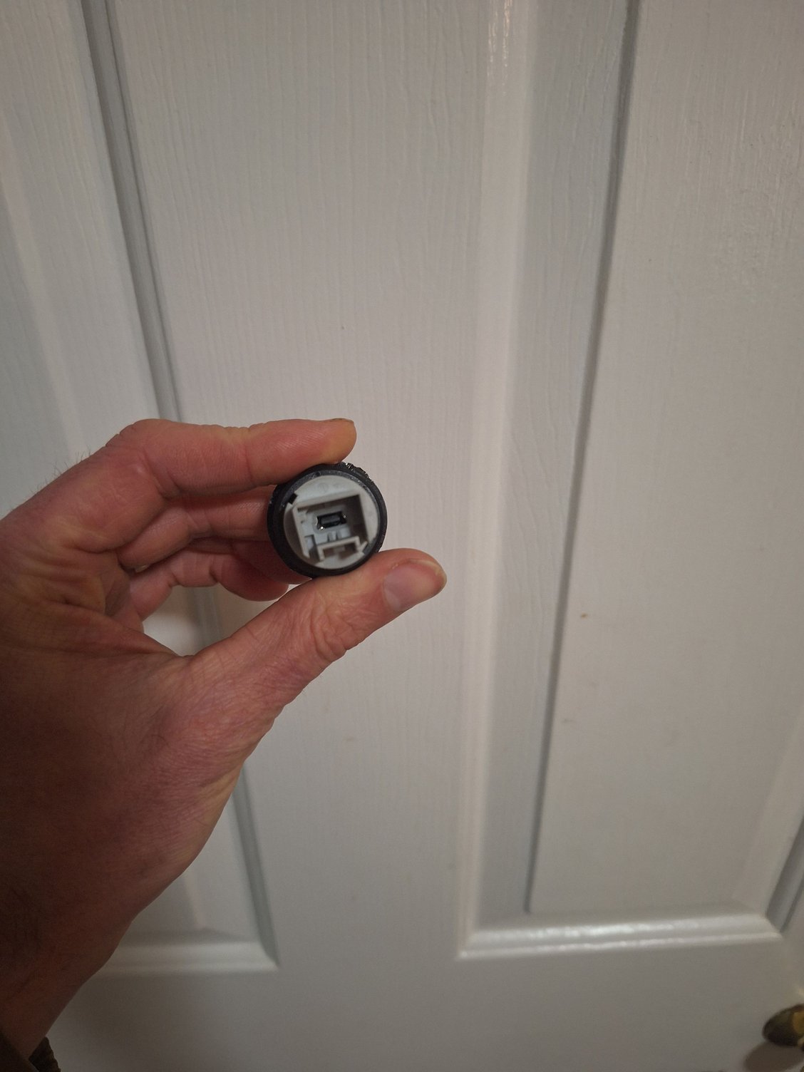

Thanks guys, that was the hose. Its pretty loose fitting. Im sure I yanked it off while trying to get one of the wires off. Not sure if the nipple was supposed ti be longer or if the tip of the hose got too soft ti stay on tight. Guess ill just replace it. Van only has 108k miles now I have to figure out what this connector is for

USB. It is useless without the factory radio. It is meant to plug into one of these
