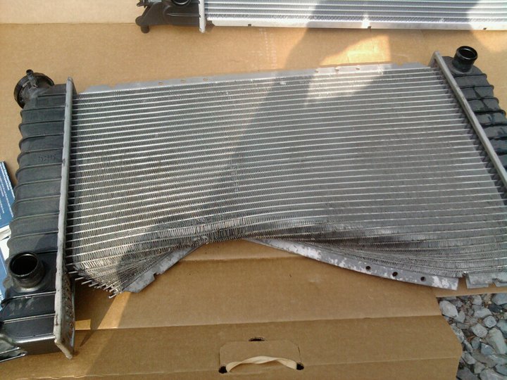

3 new u-joints and its running like its supposed to. 2 piece drive shaft, who new. Some how managed to get a floor jack shoved through my radiator, but thats a whole other story.

No doubt. $85 an hour for the shops around here is obscene. It's just a drag cause I was really just fixing this thing to sell it. Oh well. Whoever buys it is getting a truck that's in pretty damn good shape now.
