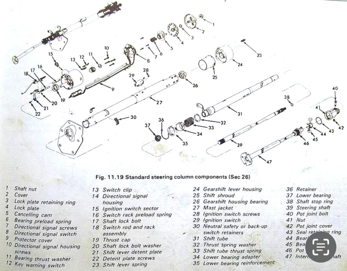

The key can get stuck, which is usually the result of the tumbler pins sticking/binding, which can then prevent the cylinder from rotating.
What’s more often the case is the gear strip (actuator) that the key cylinder engages is gummed up, worn out, and/or broken (ref. part #18 in illustration below).
Your column may not be exactly as the one pictured but it will be close enough to give you an idea of what to look for.
The inside end of the key cylinder engages the actuator with a basic, straight-tooth gear mesh (if the cylinder has a rectangular or spade-shaped end, that is what engages the actuator it fits into a mating gear that meshes with the actuator). The passage in the column housing collects debris over time and can interfere with the gear movement and even causes breakage of the gear strip and linkage.
There are some aftermarket replacements and/or repair kits - Dorman - Ignition Actuators is one option.
If you can provide any ID information at all from the column (even a photo of the ignition switch electrical connector) it should be possible to find exactly the parts you need.
You’ll likely need to at least drop the column, if not remove it, to repair the actuator or linkage. I’d recommend removal because it will allow easy access to the entirety of the column for cleaning, repair and inspection.
Part# 18 is the actuator & linkage
