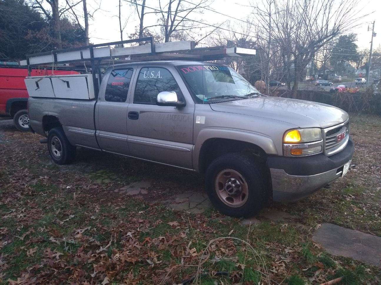

Hey guys, I had a couple questions I can't seem to find the answer to for my swap.
I just bought a 2002 8.1 truck so I have a full donor
My burb is a 1997 K2500 5.7L.
Most of the swaps I've read about are older and required transmission upgrades or major mods.
I'm fairly certain my 4L80E should work for the swap but I can't seem to figure out if I need any adapters or sleeves to make it correct. Or the converter....should I have a higher stall rating for the big block and extra power?
Any help would be great. The wiring I can take care of, I'm going to basically re-use everything from the truck, but as you know, the truck has an Allison which I don't want to use.
