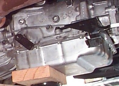

shallow pan 2-1/4"
deep pan 3" (notice the step)

Yep, great example pics and the deep pan with the step looks like my old 2002 Tahoe pan.
