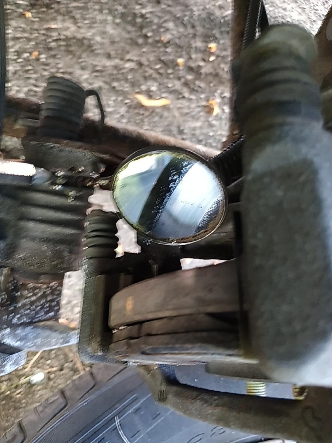

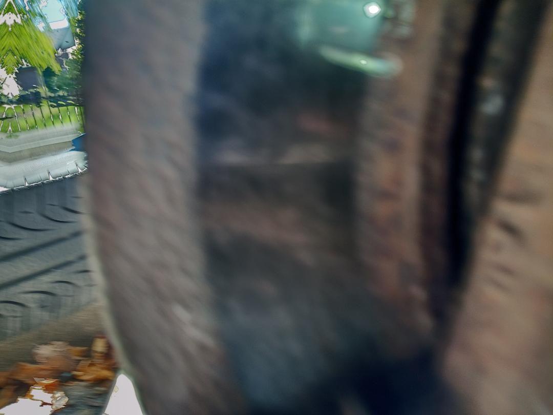

Below are the pictures of the inner rear brake pad and the inner rear rotor's surface. As with the front brakes, the inner and outer pads and rotor surfaces look differently, although there is much less of a difference. You can see the rotor surface in the little mirror.
The outer pad thickness is 6.5 mm. The inner pad thickness is 5mm with shallow scratches. Should I do anything at this point, or should I continue to drive and just to monitor it.
P.S. I drive usually two-three times a week, relatively short distances, although it's in the city with pedestrians, traffic lights, etc.,

you’re fine for now that’s normal wear and normal rusting, that rust line at the outer edge is what caused the lines in the pad and was most likely the rustling sound you were hearing, i would monitor it, let those pads wear down, then replace pads and rotors when the pads are thinner, or if you have the time and money you can replace them now, it’s up to you, but you’ll be fine if you wait. Front and rear brake wear will always be different, most of your stopping power is in the front, it’s about 70% front 30% back, so you will see a difference.
