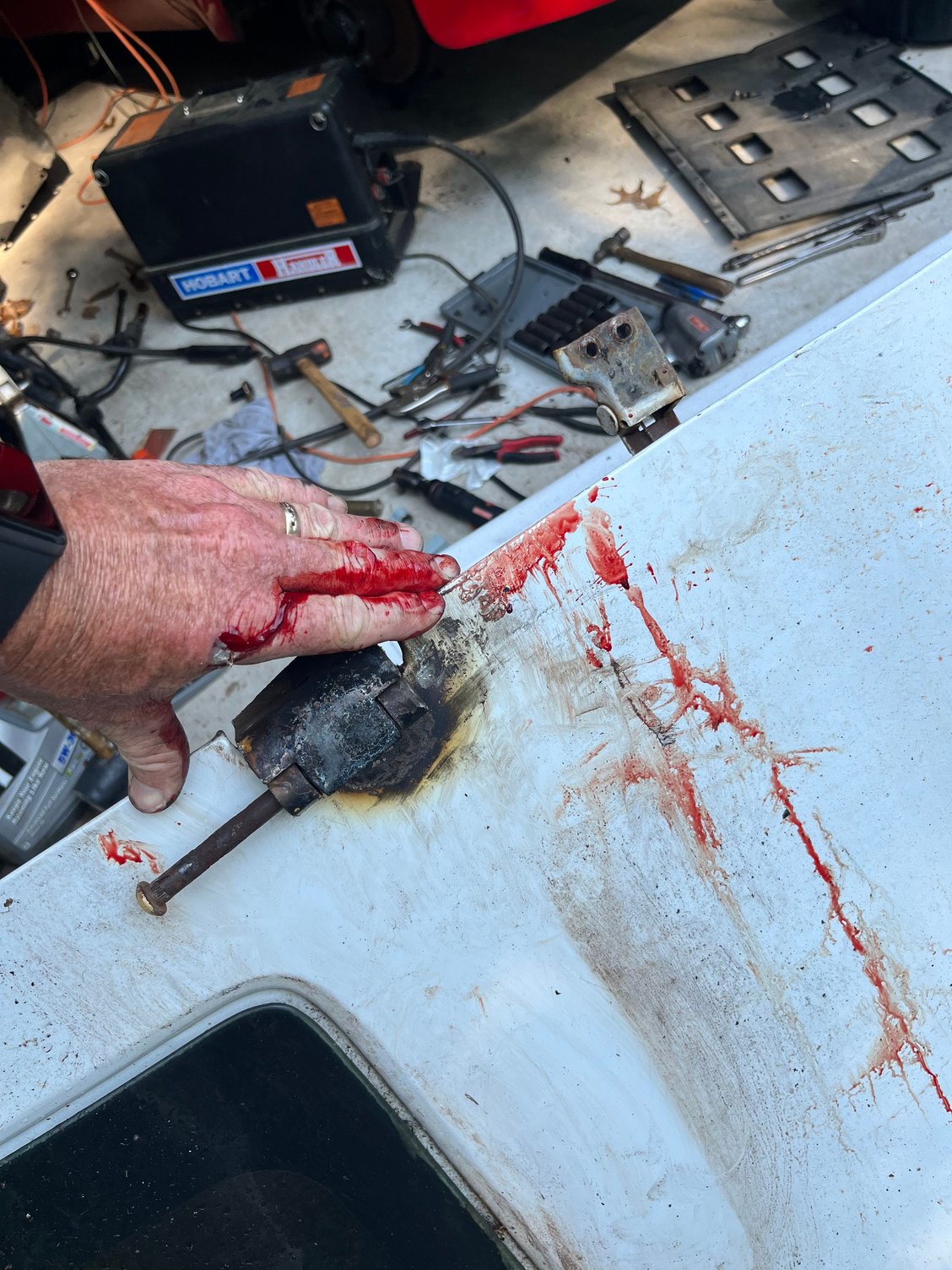

Default Mine came out with some cost
Originally Posted by gojaxon
The side door hinges on my '03 chevy express have broken and I have to remove them. They appear to be welded on but I heard a rumour they were glued on. Any ideas on removing them from the door?
a little heat and a brass pin with big hammer got this out.
