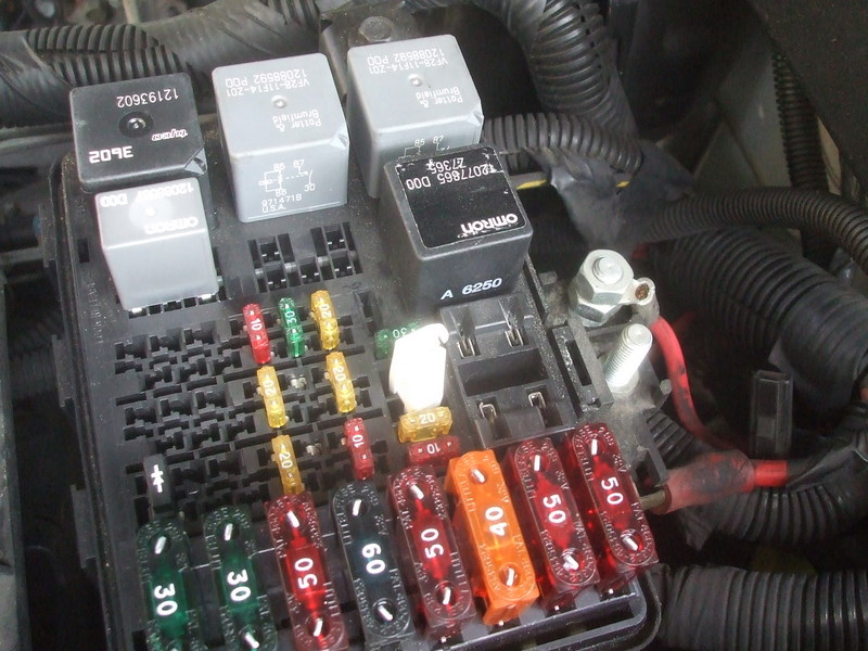

Old Jul 6, 2010 | 7:16 PM
Likes: 47
the bypass wire of which you speak in located in the wire bundle near the master cylinder near the fuse panel....
apply 12v to the connector and the pump should come on
Attached Thumbnails HELP!  97 GMC Sierra not happy....-dscf0227.jpg   HELP!  97 GMC Sierra not happy....-dscf0228.jpg
