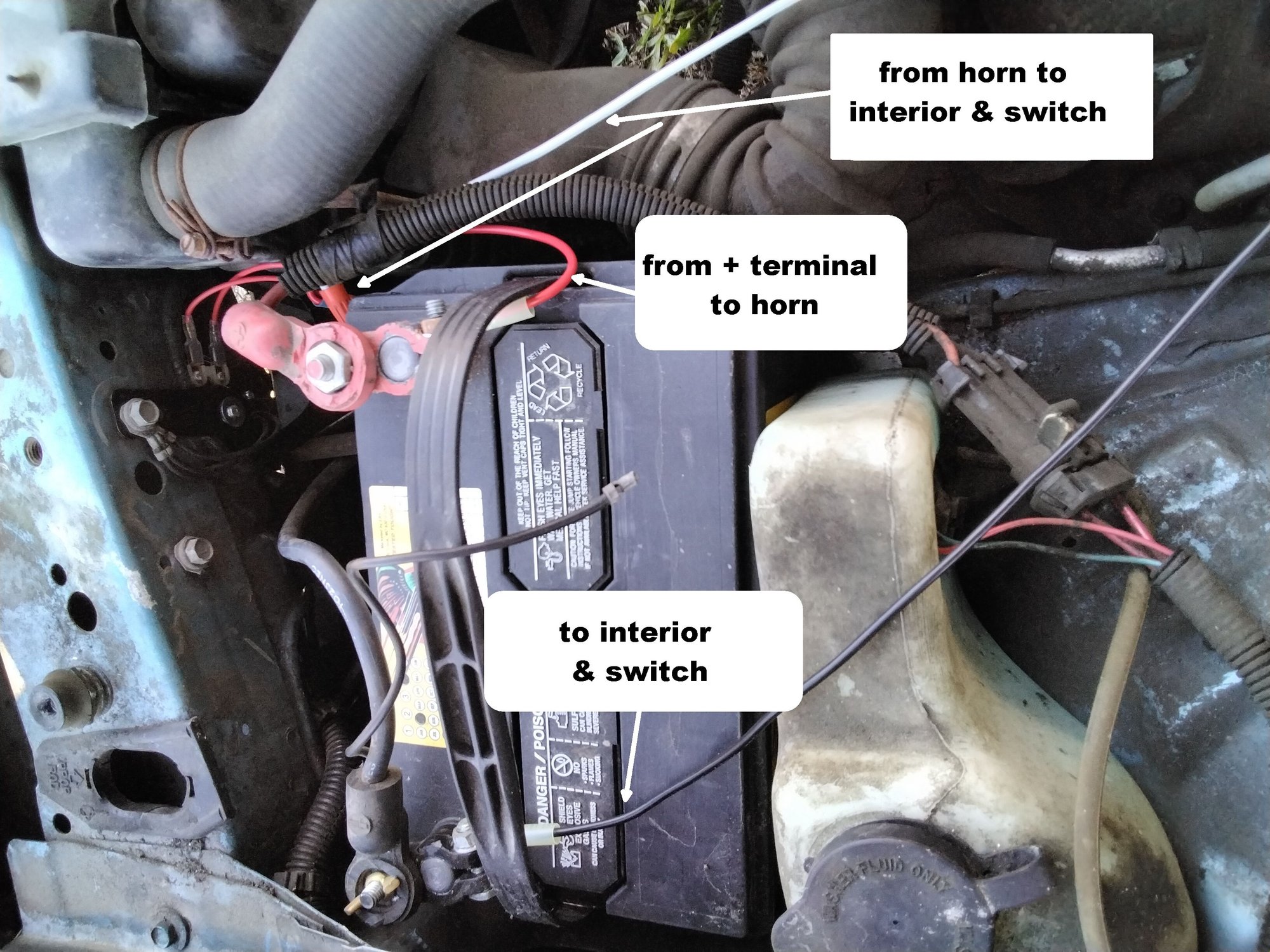

Replacing the horn relay on an 89 Chevy Celebrity is a real bitch, so I am attempting to install a simple horn with a push button direct to the battery.
The button I have has 5 wires black,red,green,blue, and white. It can light up, but I do not care about that or want it. The less power it will use the better. I just want it to blow the horn when the button is pressed.
How I have wired so far.
[img alt="5 - wire horn switch, rear view.
Which wire should white connect to?"]https://cimg7.ibsrv.net/gimg/chevroletforum.com-vbulletin/2000x1626/horn_4_89_chevy_celebrity_f946e9327389b66b2ce1e12c 5f063e1108871f59.jpg[/img]
5 - wire horn switch, rear view. Which wire should white connect to?
I have wired the horn with a red to positive on the battery,and a white to the interior to go to the switch. I have a black wire from the negative battery terminal to the interior and wired it to the black on the switch.
Where do I need to put the white wire in order to get the horn to work? I have tried them all and get nothing... other than I can get it to light up if I attach it to the red wire.
4 cylinder, 4 door, 89 Chevy Celebrity

Not all the images are showing up, but I suspect the switch isn’t capable of the current flow required for the horn.
If this is a kit you bought, check the manufacturer’s website for instructions/tech support.
Otherwise, you’ll probably need to add a relay to make the circuit work.
