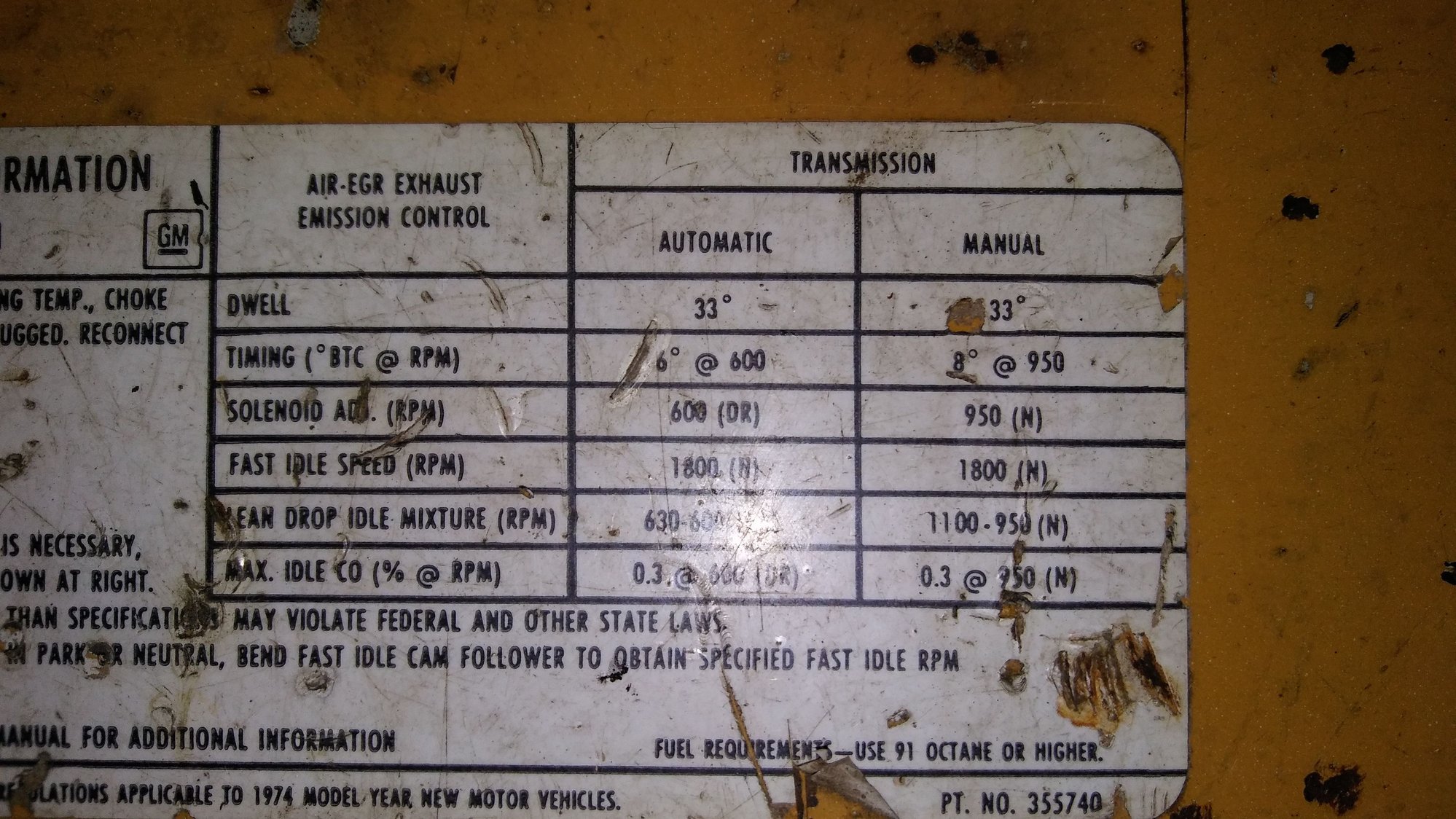

I'm sure it is plug one, on that motor it's really hard to not find plug one, also on another note I have rebuilt the carb and now the mark is now bouncing between -4 btdc and 0 so it's better, going to try to regap the points today also I have this pic under the hood.
It is a manual but I don't have anything that will read in degrees for the dwell, I did a dwell test with the multi meter and for once it's steady started out at 088 rpm and one it warmed up it went to 101 rpm the meter is X10 rpm, so I'm stumped as to the degrees of dwell it should be at.
Old Apr 13, 2017 | 6:14 AM
Posts: 6,232
Disconnect the vacuum line to the advance on the distributor and plug the vacuum so there is no leak. Does the timing still jump around?
