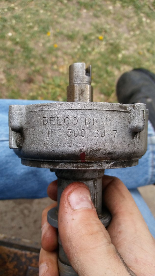

Ok guys I dove into this a little more, pulled the distributor and found that the roll pin was worn so the drive gear was lose side to side, so I replaced the roll pin now the gear is tight, but still had the motor shaking when accelerating so I started pulling vac hoses, I got to the vapor canister that has a removable top where the carb line goes in, the diaphragm inside was ripped, so I'm in the process of trying to get that fixed, can't afford a new canister at the moment, but I added a pic of the distributor with the gear removed.
