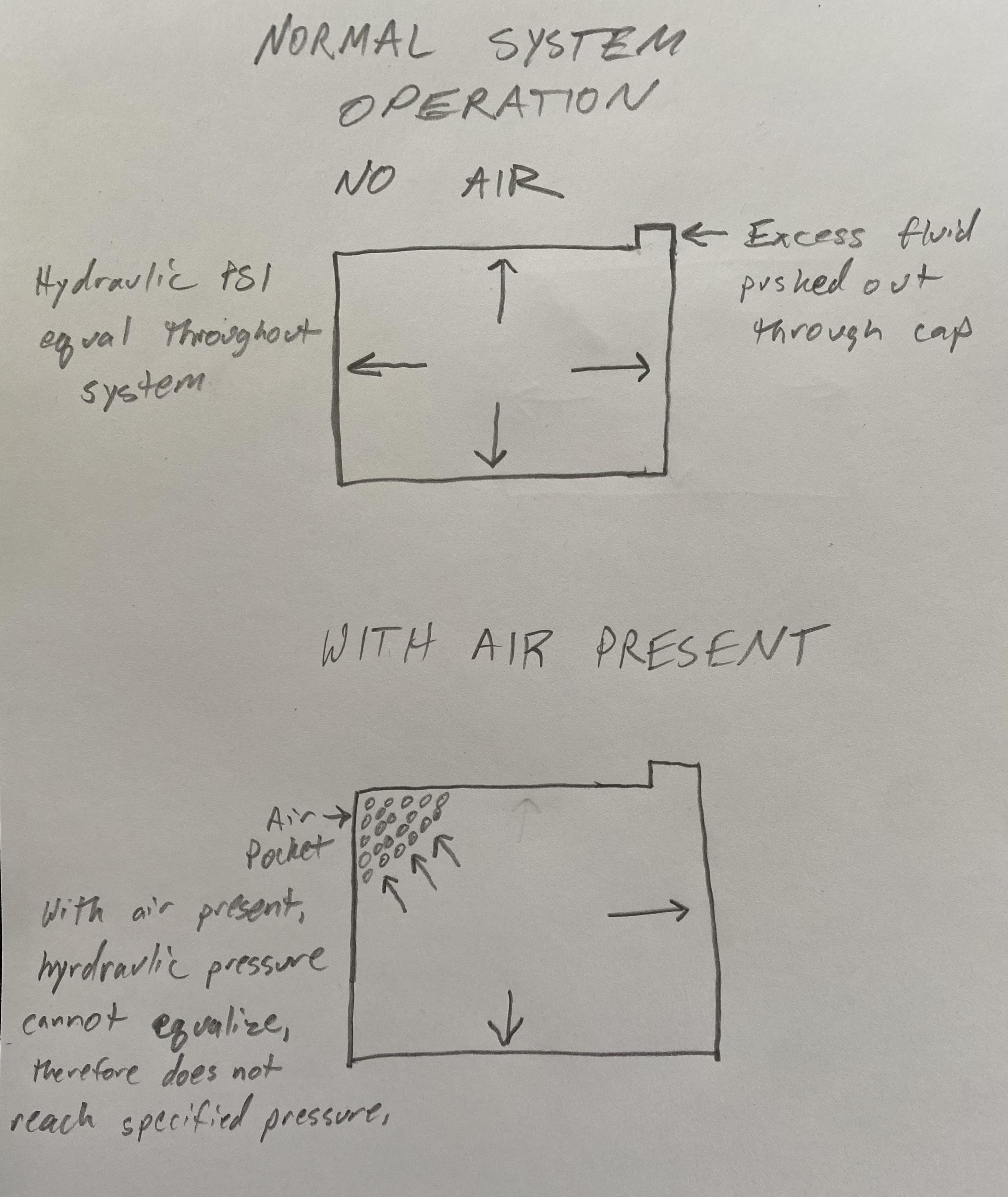

Not always true. In the event of sudden pressure release, yes, the coolant will boil; but if the system is never pressurized to begin with, the coolant only boils if the heat isn't adequately transferred to the radiator and cooled off by the fans. I've seen several vehicles with faulty system caps that didn't hold pressure at all and otherwise ran fine and had no problems with boiling coolant. One method for purging cooling systems after major service is to fill the system as full as you can, then run the engine up to temp with the cap off and add coolant once the thermostat opens. This is also how some combustion leak detector kits check for the presence of exhaust gases in the cooling system.
I think the "expertly drawn illustration" below will help demonstrate my point.
For those that may need an explanation of the principles at work here -
Pressure in the cooling system builds when the coolant expands as it's heated, due to the coolant absorbing heat from combustion. Eventually the volume of the fluid expands beyond the volume of the system, at which point, pressure begins to build and when the rated pressure is reached, the excess fluid is expelled through the radiator cap into the overflow container.
The reason pressure is necessary is because it raises the boiling point of the coolant, allowing it to reach much higher temperatures than it would at atmospheric pressure.
Since coolant is a fluid, it's classified as a hydraulic system. One principle of hydraulics is that pressure is equal at every point in the system. So, a rating of 15 PSI means the radiator, block, heads, hoses, and heater core are all at 15 PSI in a normally functioning system.
System rating is determined by many things including the materials used to build the engine, radiator, heater core, and hoses as well as the expected operating temperature of the engine. Most systems today are in the 15-18 PSI range.
One other principle of hydraulics is that liquids can't be compressed.
Air, on the other hand, can be compressed. That's why air in your brake system causes the pedal to feel spongy - because the air is being compressed by the fluid. That's the same principle I'm basing this theory on.
Keep in mind - this is a THEORY based on what I know to be true of how cooling systems operate and the properties of fluids and air. It is far from an in-depth analysis and I've not had the opportunity to test it or collect data. Even if it holds some truth, I don't know how much air in a system would be required for this to occur.
Now, obviously, the situation below couldn't actually happen as it's drawn - I'm only trying to provide visual aid to demonstrate my point.

Old Feb 14, 2021 | 7:34 PM
I'm with you so far. It takes more volume of gas to squeeze that air pocket to 15PSI (like a spring), than a liquid. But I think it's easily reached. 15PSI isn't that much.
The temperature inside cylinders can reach thousands of degrees. More than enough energy to vaporize the coolant.
