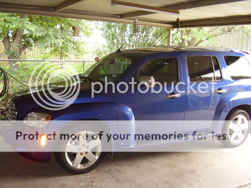

I had the same thing, they said it had something spilled down in the shifter, we never did but could have been done before we got it on a test drive? Name:  P7290009.jpg
