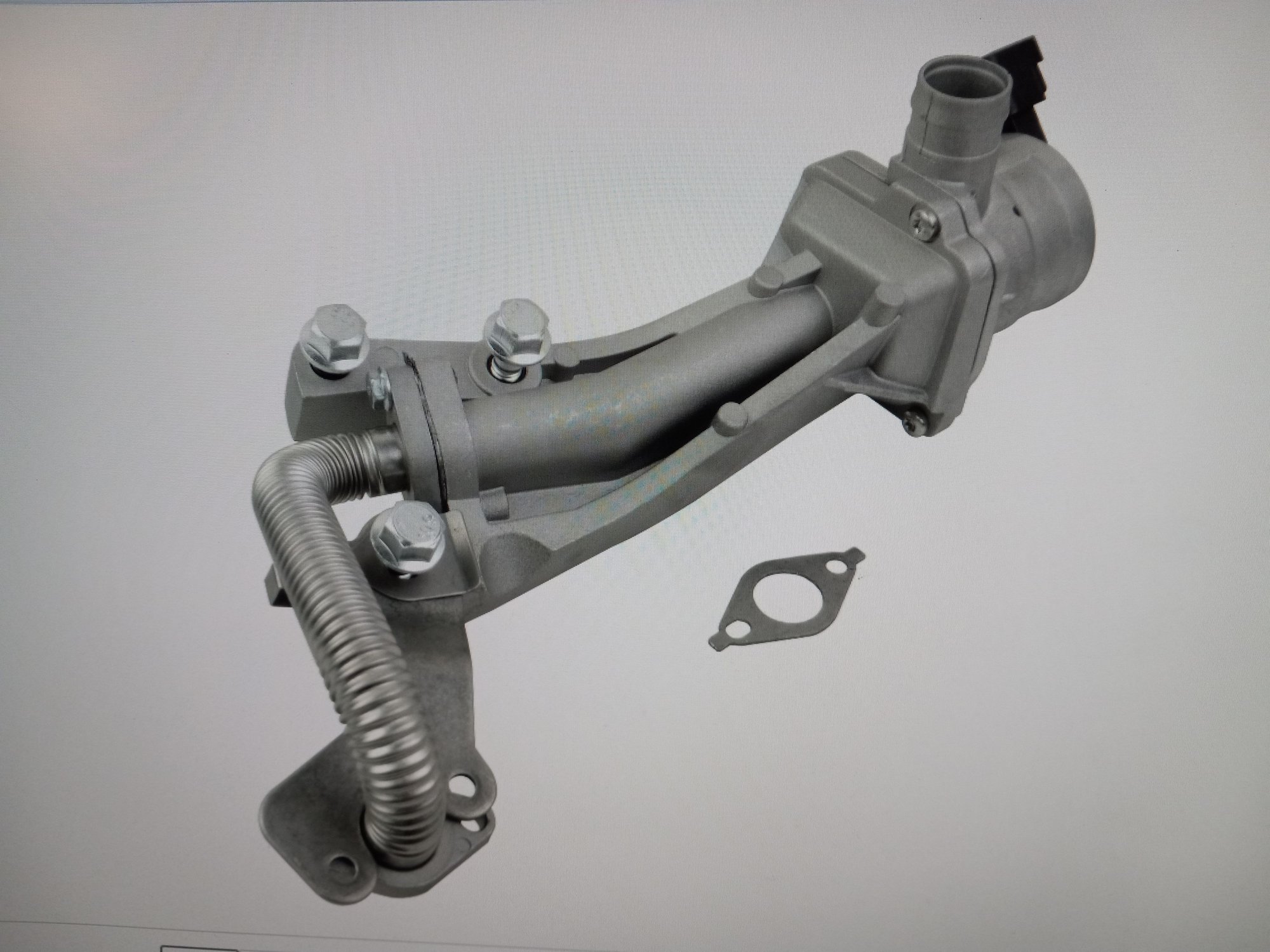

Default Check Valve
Originally Posted by Jeff Hawkins
Same problem on my 07,checked blower found full of water as seen in other posts,drained still works.will try to drill small drain hole to let any buildup seep out and replace valve soon.About $165 plus shipping on Rockauto.com.Good luck.JH
Hi Jeff, I also have an '07 Impala. I recently bought it in August with only 23,700 miles on it. Just a few days ago, check engine light came on. I stopped at my local Auto Zone for a free scan, it came up with the PO411 code. The printout that they gave me suggested that I replace the Air Pump Check Valve, but the picture of it that they included is probably wrong. It's the first one here, the dark colored one that looks like a piece of cake to replace. The next pic is the one that I'm assuming is the one that I'll need to replace. I'd just like to confirm that with you guys before buying it. (aluminum color with the tube on the bottom) Also, would you suggest getting AC Delco, or is an off brand ok?? 1A Auto wants $323.00 for AC Delco. Ouch!! Thanks Guys!!
