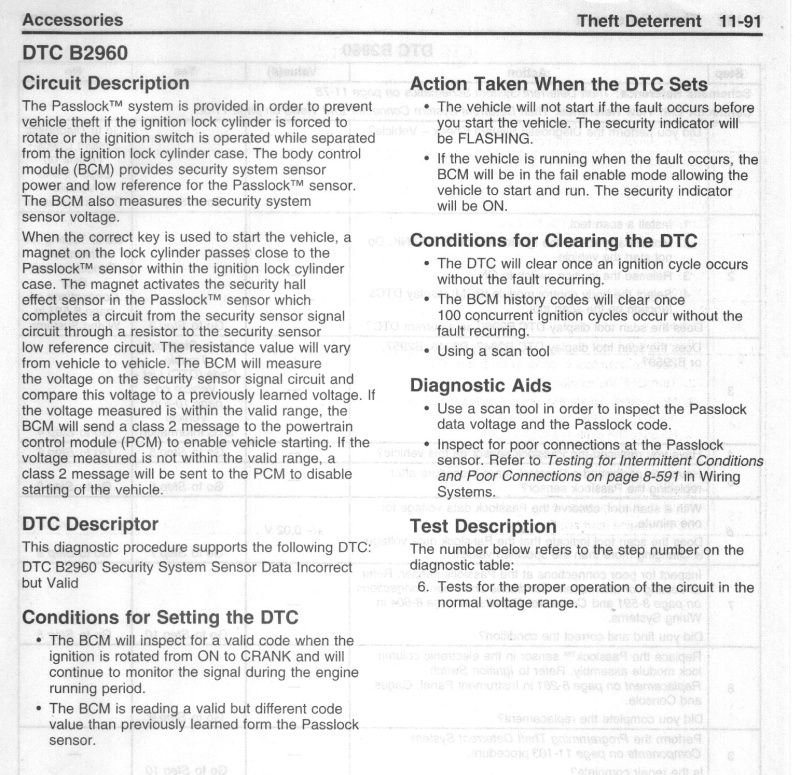

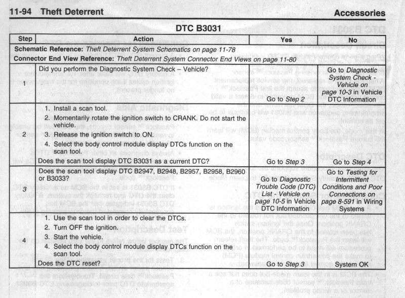

Attached are scans of the two trouble codes for reference from the factory service manual. What do you guys think??

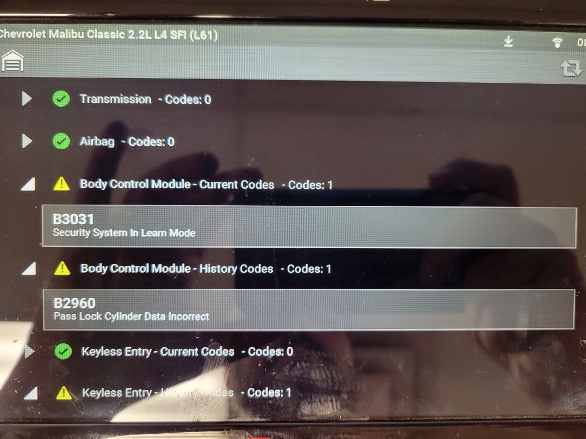

Here is a pic of the scanner coded that it found (that last ! was from a low battery event, the battery was replaced nothing to do with this). The 2960 I believe was the event last Saturday that my scanner didn't show, I don't understand the 3031 that popped up out of nowhere when he was troubleshooting last night.;
