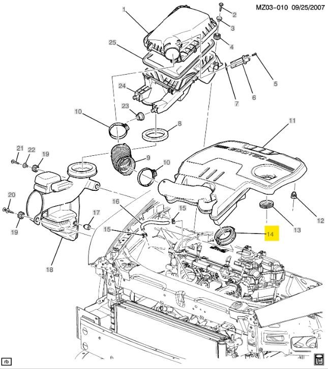

I've been having some accelerating issues and someone had me check that rubber part (ignore my terminology. I'm not a car person) that is under the engine cover. It's 14 on attached diagram. It's cracked. My problem is, I can't find one. It seems like when I check a couple of sites, it says that part is part of 9,10, 12-14 as if I have to purchase that whole package. I just need that part. I'm told it's called the air cleaner outlet duct clamp.
It's not available to buy separately. It's part of #11 the cover. GM part# gm 25842350 or 25842351
https://nemigaparts.com/de/cat_spare...z/03/mz03-010/
However you need to double check that because what you say doesn't make sense.
It's a 2010 Malibu LZ, gas.
I've never heard of 'LZ' trim. There was LTZ, but that one had a V6 engine. The diagram you posted is for an inline 4 engine. The V6 diagram is here:
https://nemigaparts.com/de/cat_spare...g/00/rg00-020/
The cover is a $500 part, so your best bet is to visit the pick'n'pull as tech2 suggested.
