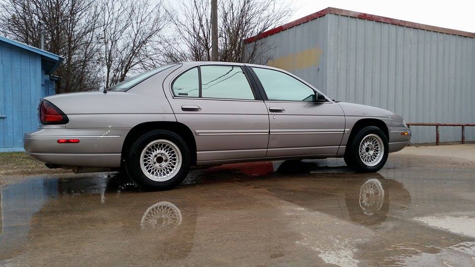

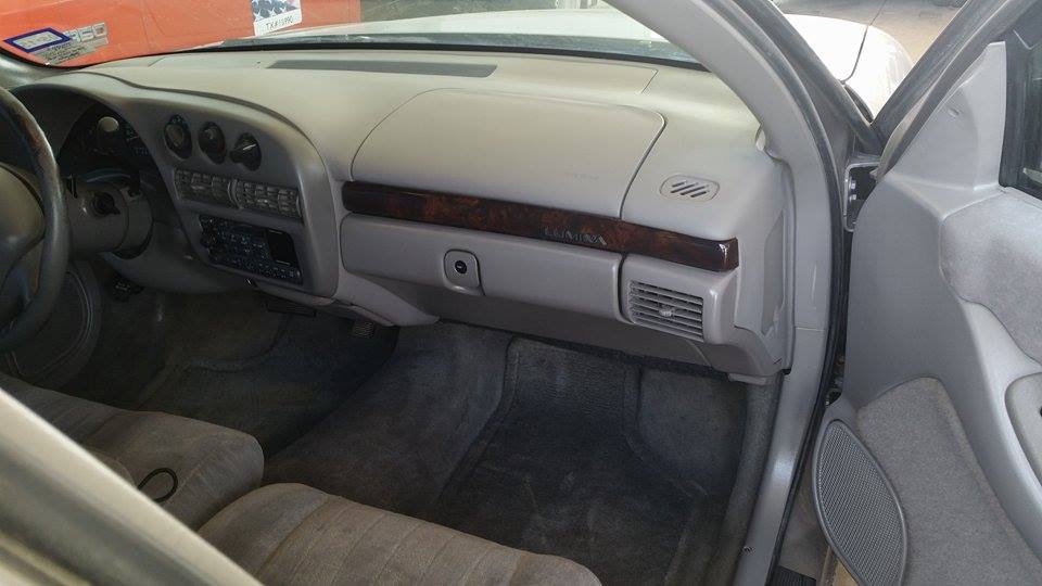

Ok I have a 97 chevy lumina that has been in the family since brand new in 97 and is still just like a brand new car in and out that has over 340,000 original miles on it and have had no problems at all with it since new well till 9 months back it started leaking around the thermostat housing area and I know of the head gasket problems they have with these cars. So I put in head gasket fixer bars leak and it fixed it. Then a month after water pump went out so replaced it and right after I replaced the water pump it was running hot with the temperature gage jumping all over and heater not working and then read online and found out you have to bleed the system on these cars so I did that and it fixed it and had no problems after that at all till today it started leaking again around someplace by the thermostat. Any ideas? I see something that looks like a freeze plug where all the antifreeze looks like it is coming from is their one there? I did some research on how to tell if it a bad gasket and there is NO signs of what all I read that it is of either a bad head gasket or intake gasket... So if you have any thoughts here let me know.

So why do we get pictures of your interior and not of the freeze plug area?
it could be running down the block.
You should pressure test the cooling system when the vehicle is cold, that way you can see where the coolant is running/dripping from exactly.

Because I can't get a picture of it way too much stuff in the way. I barely can see it with my own eyes with a flashlight when looking through a small opening. When i do try to take a picture it just won't show up just makes everything up close bright and the rest down the opening dark..
