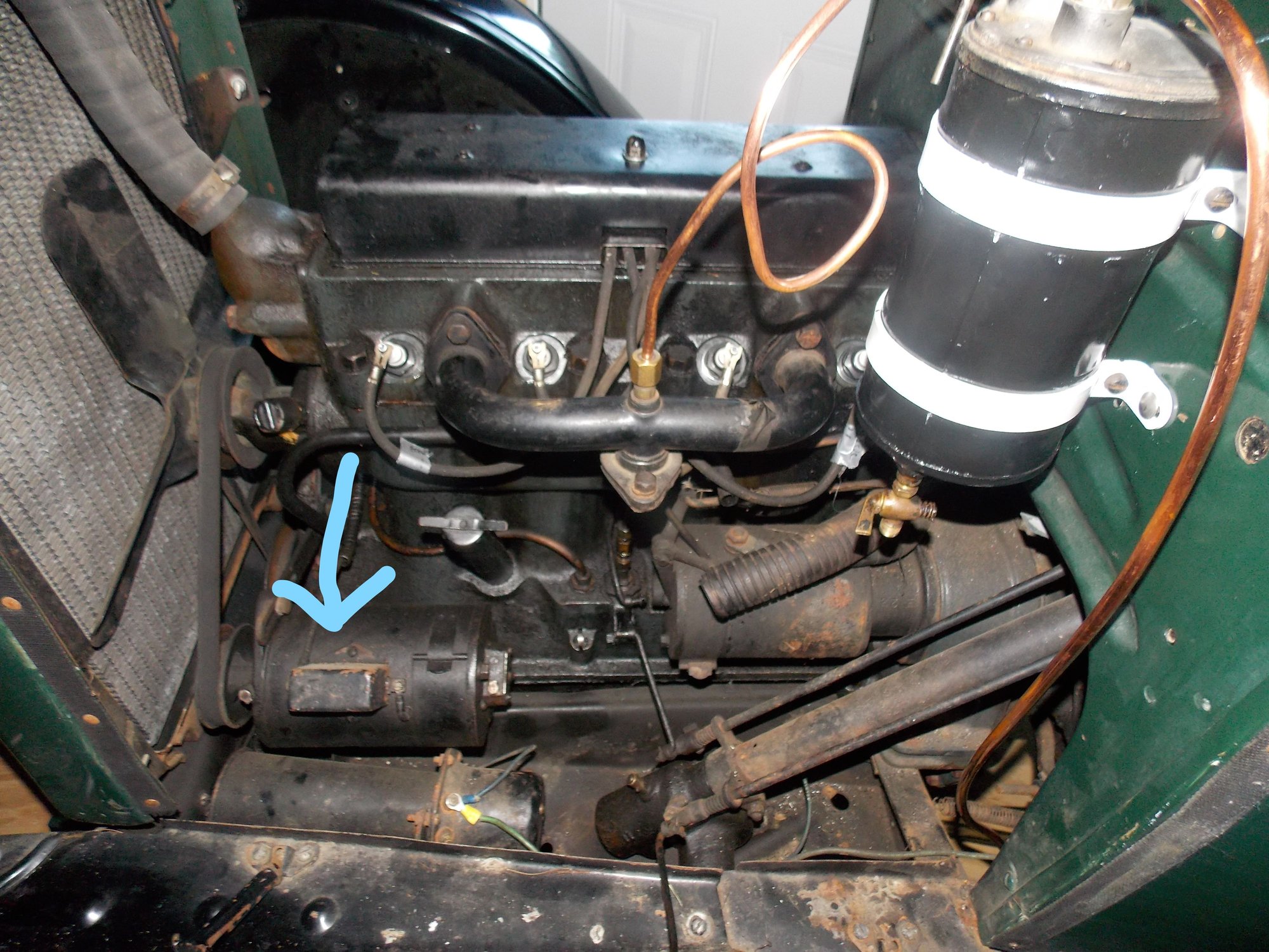

Morning, Thanks for the reply. Not sure - but would the voltage regulator be the little part on top of the generator covered up by a cap. I posted a picture of what I am talking about. I don't recall 'finding" a VR when going through the manuals. Thanks for the reply,
Not sure where the regulator would be located.
Old Jul 16, 2021 | 7:39 AM
Posts: 6,232
That box on the generator is a cutout. The way to adjust the voltage output is by adjusting the third brush in the generator. I don't really know how to do this, but moving it slightly will increase or decrease the voltage output.
