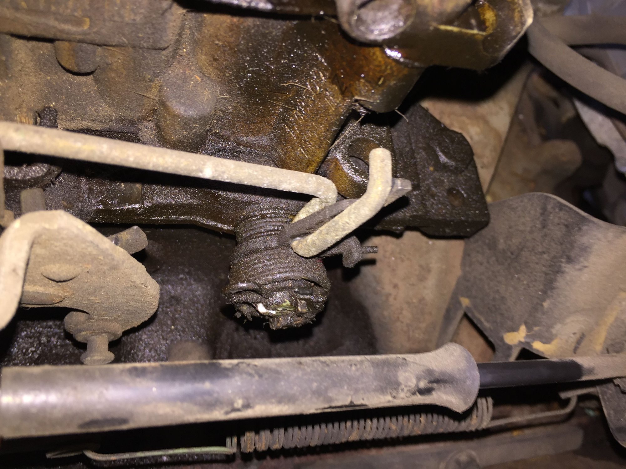

hey folks, have a couple things im hoping to get some guidance on related to my 85 custom deluxe 10 pickup.
Firstly, the idle speed is insanely high, but im not sure where the adjustor screw is. The air/fuel mix is fine, i just want to decrease the running idle. Can literally drive faster than 40km/h with zero gas pedal, needless to say this thing is a gas guzzler.

The idle adjust (since this is a carb. engine) is on the carb where the throttle attaches, unscrew the adjustor will allow the throttle to back off, and thus decrease the idle speed.

Throttle is the lever that revs the engine right?
And then would this be the adjustor screw? Its flat head screw and both awkward to access and seems to strip like butter, just trying to be 100% sure before climbing up and givin er. Also should the truck be in neutral?

Should be blow the diaphram (dash pot, choke pull off), the green linkage end that attaches to the carb, look underneath for an adjusting screww

I can tell you looking at the first image it is WAY off the idle, the linkage should be (cold) on the dash pot, touching
