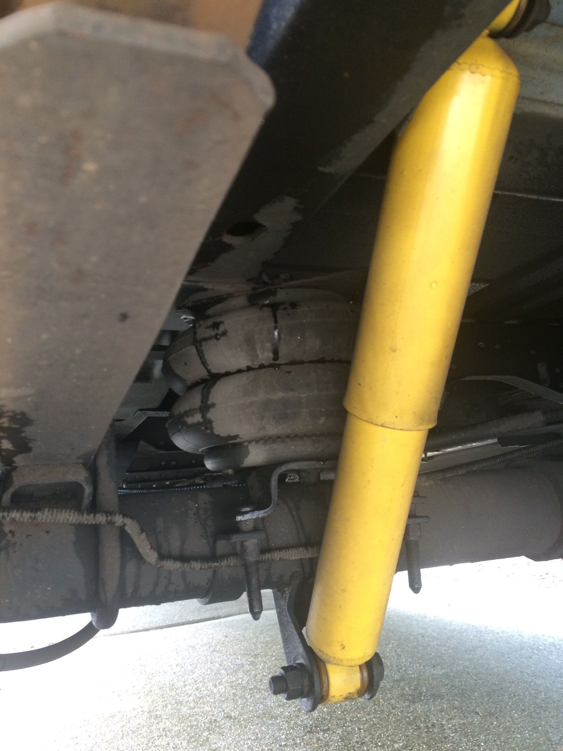

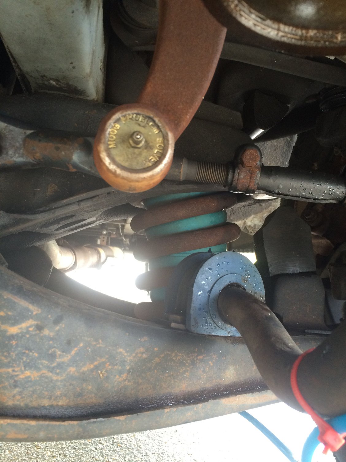

I used a Firestone air bag kit in the rear and I can get a good 3" same with the coilrite bags up front. But one of the bags up front already has a leak somewhere. If you want suspension stuff, the mid and late 80's trucks have the same suspension and motors (Tbi trucks) that's how I found the kit.
Since the front bags already crapped out I've been looking at a set of bags that replace the coil spring, but they say it will give me stock and lower height. I'm sure a couple of 2" spacers would fix that.
