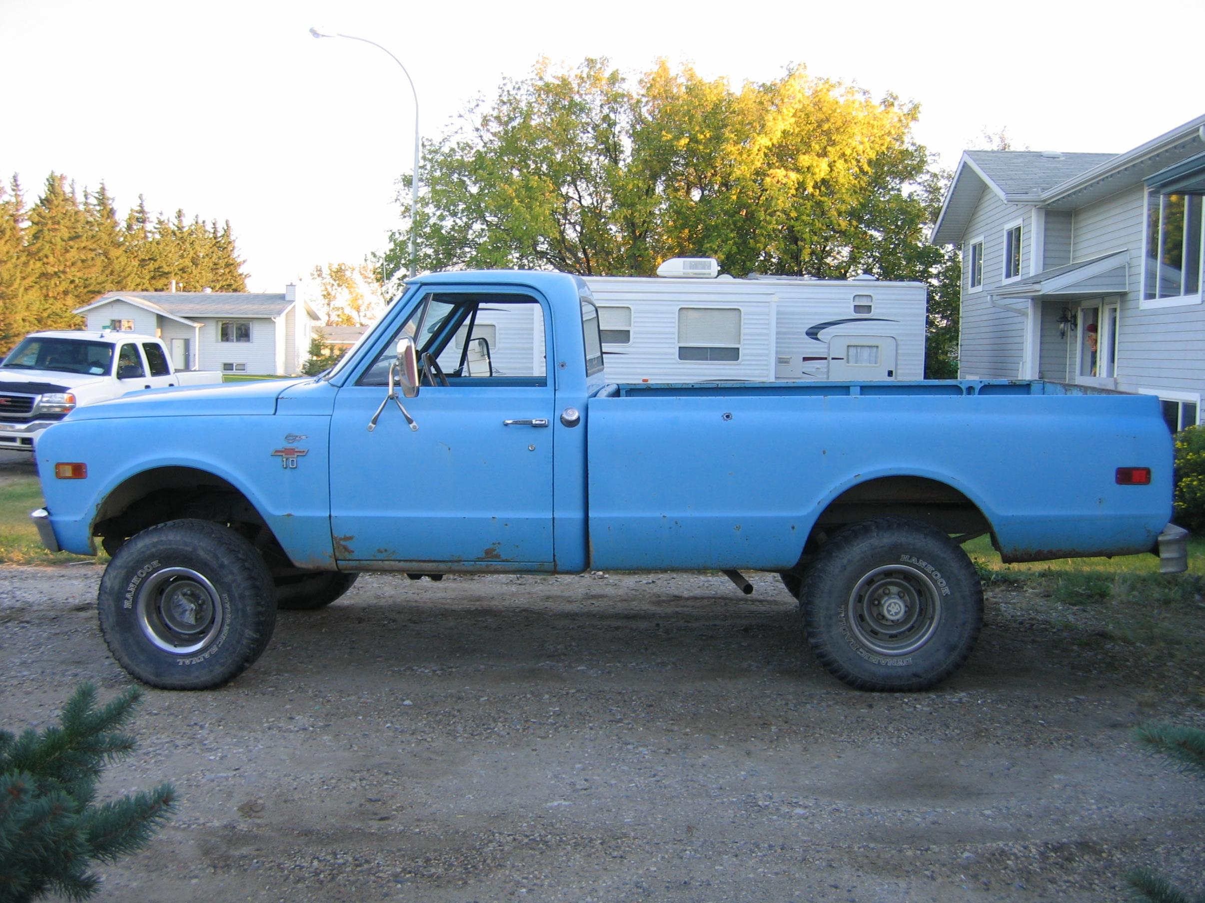

Well I have some good news and bad news. I haven't been able to touch my truck since I started this thread due to some life complications, but I was able to track down the original owner of this truck when it was built up. He claimed the chassis and box came from a 1972 Chevy. I was told about the possibility of a stamped vin on the frame but wasn't told where to find it so thanks for the link Gary. I will see if I can locate it.
Old Jan 22, 2010 | 4:44 AM
littlepapapump_04's Avatar
Joined: Mar 2009
Red face
Wow!!! I've finally been able to go through the truck! This truck is a complete throw together. Mods and repairs up the ying-yang. No problem though, like Mudmaniac said "if you intend to use it only off road that you look at all the previous work and judge it buy fit and function.") It seems pretty well put together so it will make a good truck to turn into a play toy.
It's a big mix and match, and I shouldn't have to change a whole lot. The drive train is solid and fairly tough, so a lift, gears and tires should do it.
350 V8 - rebuild
turbo 350 - rebuild
NP205 - rebuild
dana 44 front - keep
GM 12 bolt rear - keep
3:73 gears - change to 4:10
33x12.50x15 - 35x12.5x15 or 37x12.5x16
Suggestions or advice?

I would go with 4.56 gears if you go with 35's or larger, if it is only for off road maybe even 5.13
