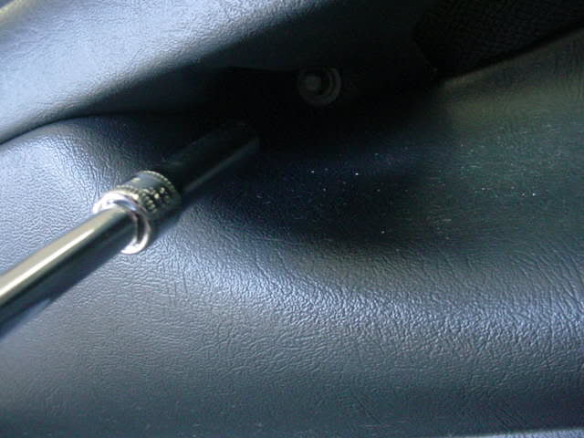

Locate and remove 7mm screws under armrest handle. (no, this is not my Blazer)

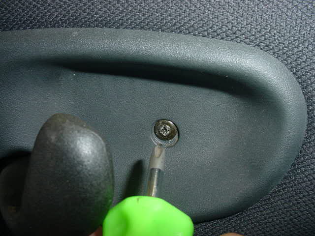

Pull door handle back and remove philips screw on the plastic bezel.

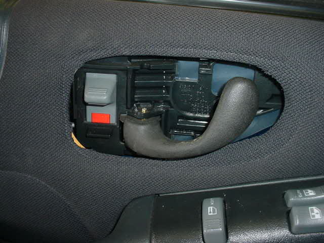

Do not pull the bezel off lock-end first. Pull the handle end out and slide it forward and up the door handle.
