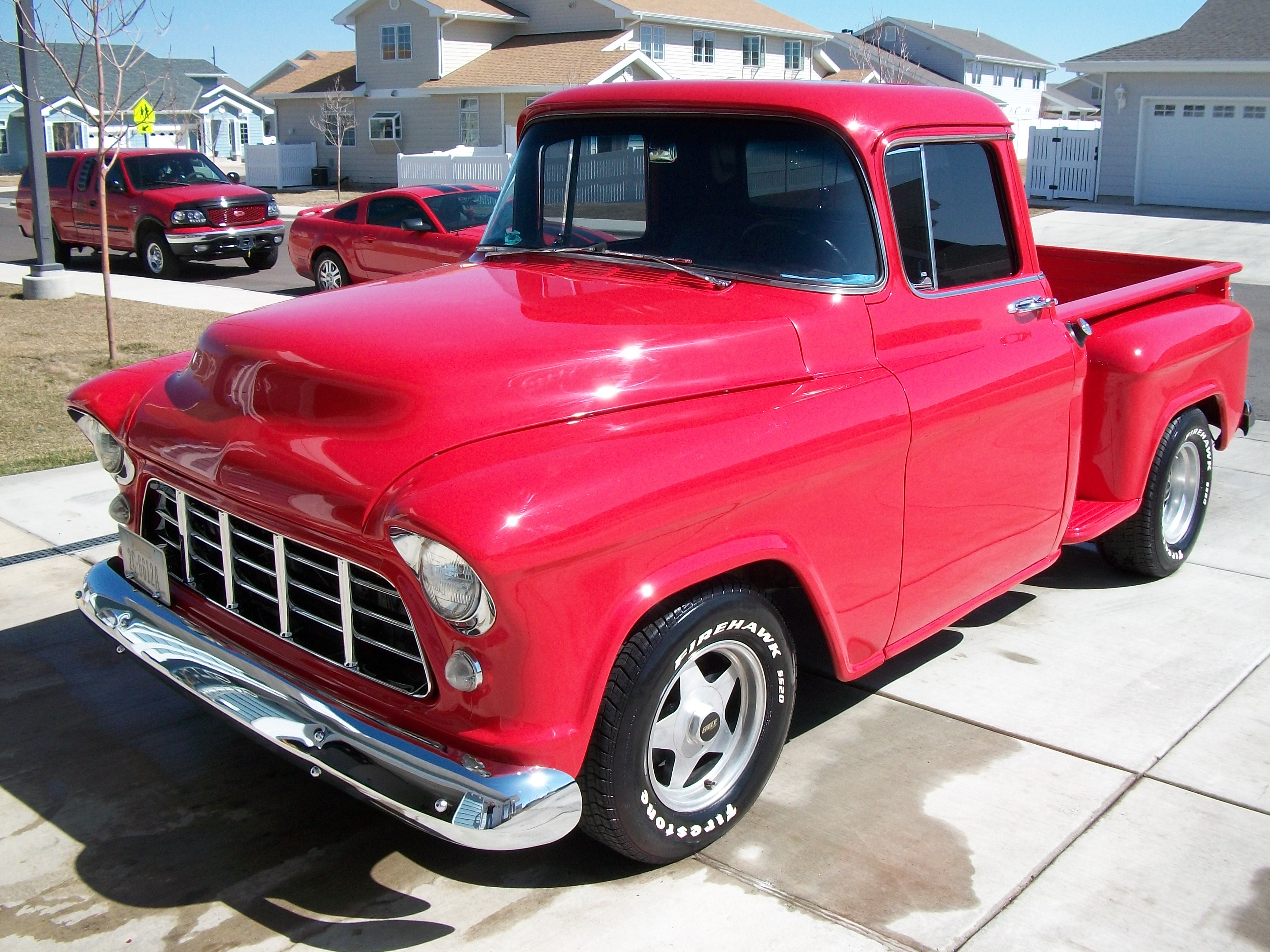

I am at a loss all. I have a 1955 Chevy 3100 with a 1978/79 305 Camaro engine. I have had it a few years now (6) and it started out starting well, then it became hard to start after a year or so and now no start at all. My brother-in-law and I have ascertained that it is not getting spark. We checked with a light power is coming from the ignition and ballast resistor side to the canister coil, but when we checked the coil to distributor there is no power and we get no spark at the spark plugs. Tested the coil with a multi meter and the numbers were low so thinking the coil was bad, got a new coil and same problem. Returned new coil put old back on. I have changed the points and condenser. I am open to any suggestions you may have. Thank you in advance for your assistance.

What did you set the points at? Check the condition of the wire from the distributor to the coil. By the way, that is a nice looking truck!
