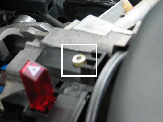

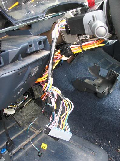

Originally Posted by northey87
12. Now to disconnect the old unit. You may need to take the plastic wire tape off the bundle of wires going down the steering column into the dash so you can get the wires out. You can do this carefully with a pair of scissors. You will now need a 7mm socket or nut driver to undo the bolt holding the plug together (12-1). Once you have unbolted the plug, you can then precede to unplug the plug block (12-2). Now un-clip the two plug strips from both sides of the plug block (12-3). There is also a pair of wires (green and black) that go to the flasher unit that you will need to unplug. Just follow those two wires to the flasher and then un-clip the plug then unplug. All the wires coming from the turn signal unit should be free (12-4).

13. Now you can finally remove the old/broken unit. Use a letter "V" torx driver to remove the top bolt (13-1). Then using the same driver, you can unbolt the lower front bolt by inserting the driver between the steering wheel and the steering column (13-2). It is not necessary to remove the steering wheel to get the second bolt out, but if your model is somewhat different and you cannot get the torque driver through the opening then you may need to go ahead and remove the steering wheel. Once the unit is unbolted, just lift and the old/broken unit will come out.

I think I’m having trouble with the bolt in the plug box . The plug box won’t come out. It’s like it’s stuck or something. Thank you
