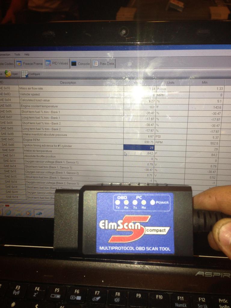

I've read a lot of different posts telling how to place the distributor but im still having some problems so maybe someone can help clear things up for me a little bit. heres what i did
set the number one cylinder to top dead center on the compression stroke.
placed the distributor with the rotor facing the number one cylinder.
started the truck but its still misfiring and its throwing the p1345 code which apparently has to do with timing.
i have an elmscan5 compact scan tool running obdwiz and it shows what timing is currently set at and its telling me that im at 29 degrees. if i understand right it should be reading 0 so i figured my distributor was off by a gear, so i rotated one tooth clockwise and it started up but it ran like crap and the timing now read 33ish degrees. so i went back 2 teeth the opposite way and it wouldn't start up at all...
anyway i put it right back where it was before and its still reading 29 degrees and misfiring (although not nearly as bad as it did before i changed the distributor) so im not sure what to do from here.

Just found out that the timing advance my program shows may not be the cam timing but ignition timing. Got another program ill try out in the morning and see if that works...

Your looking for a scanner that reads Cam Retard should be set to 0 +/-2 a tech 2,snap-on,Auto xray 6000 will read it.A dealer ship might not charge you much to set it just make sure you rev the engine past a 1000 rpm to reset the value on the scanner

have a friend with the scan xl pro software and the gm dealer addon pack. It shows cam to crank correlation and it looks like im actually within the 2 degrees. Problem is im still showing the p1345 code, since i got a new distributor with the new cam sensor on it im thinking it may be the Crank position sensor. Ill probably go pick one up and try it out but before i waste $60 anyone have any other thoughts or ideas?
edit* stupid me, setup the program wrong. got the program to scan and i was way out. adjusted the distributor and now im at 3* problem is it only ran like that for about a minute and then it started backfiring and died... hmmm
