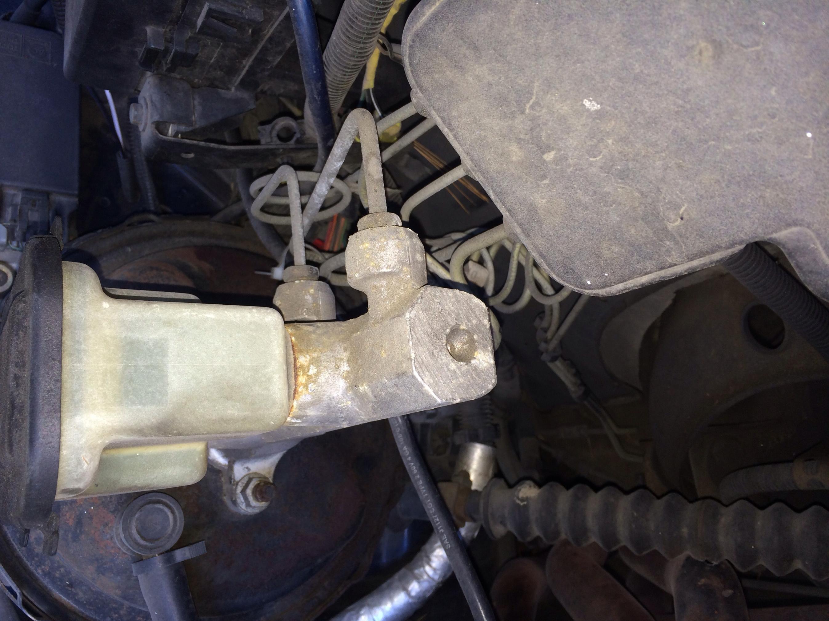

proportioning valves usually part of the of the m/c. post a pic of the front of the m/c and any junction block that the lines go to.

Old Jan 19, 2014 | 12:23 PM
Dropped95gmc's Avatar
Joined: Jan 2014
Posts: 12
From: Murfreesboro TN
Sorry for the delay in the pics, works been crazy this week
Old Jan 19, 2014 | 1:05 PM
no p-valves on that m/c

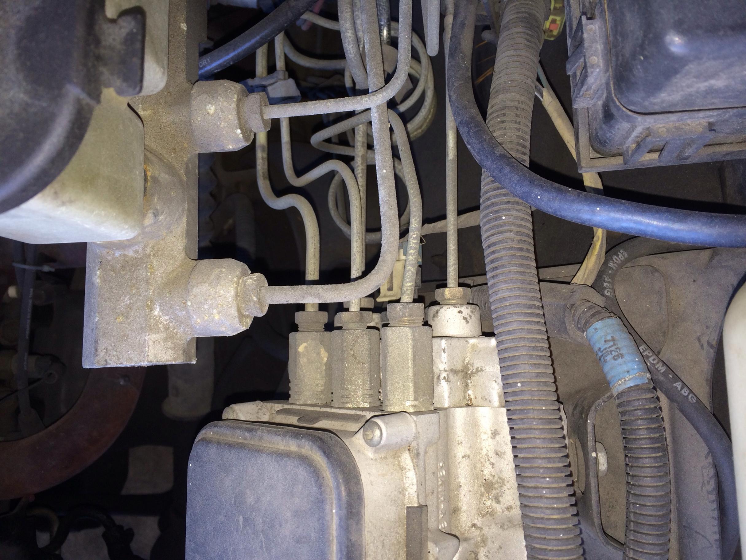

Old Jan 20, 2014 | 12:50 AM
Joined: Jan 2014
Posts: 12
Yea, straight from m/c to the pump, then out to the wheels.
