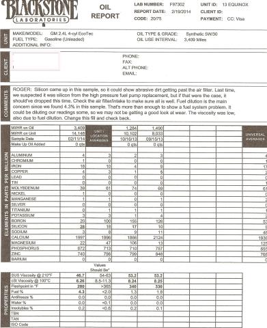

The Blackstone Lab report has a column: "Values Should Be".
For "Fuel %" they have "<2.0"
The high pressure pump was replaced last October. Apparently if that doesn't solve the fuel problem the selling dealer service department is bankrupt for alternative fixes.
Tomorrow we shall see if a different dealer's service dept. have other ideas. If not then it means changing the oil every 3k miles.

What are the fuel trim values at? When you check the dipstick; is the oil diluted and have a fuel smell?
I don't know what trim values are. But yes, I smell fuel on the dipstick.
Blackstone report shows a dilution of the oil.
The very first clue to a potential problem was the dip stick showed over full after driving a couple of thousand miles.
I had changed the oil, let it drain for hours, installed 5 quarts. But the next oil change, I measured what drained and it was over 5 quarts.

if unmetered fuel is getting into the engine, this will enriching the fuel/air ratio. The oxygen sensor detect this and will cut the amount of fuel metered out by the injectors. This fuel cut is shown on the scan tool as fuel trim. Ideal is 0% +/- 10%. When the system is at its adaptive maximum (the fuel trim is so askew the system cannot compensate and correct it) a dtc will set. Is the check engine light illuminated?
give the shop a copy of your analysis. Don't bring the car in after your oil change or everything will appear normal. bring it in when your ready to change the oil and the dilution is easy to detect.
Brought the NOX in yesterday with the last two UOA reports and without changing the oil first, 68% still on the OLM. The techs tested pressures, trim, injectors, and some other things that I've forgotten.
The pressure drop was minimal, within the specs they obtained from multiple communications with factory engineers during the day.
They had the vehicle all day trying to find or verify what the UOA reports showed. But, alas, all their efforts resulted in everything falling within acceptable limits.
I sincerely believe that they gave it their best shot.
Future oil changes will be performed by me. Measuring what drains and replacing exactly 5 quarts. The UOA will continue also. Sooner, but hopefully later, premature wear will develop and there will be these documents to fall back on. They discouraged waiting to change the oil until the OLM read "0", 20% would be their max recommendation.
The OLM has never reached "0" since I've owned this vehicle. The oil has been changed at least 6 times within the past year, 16k miles.
