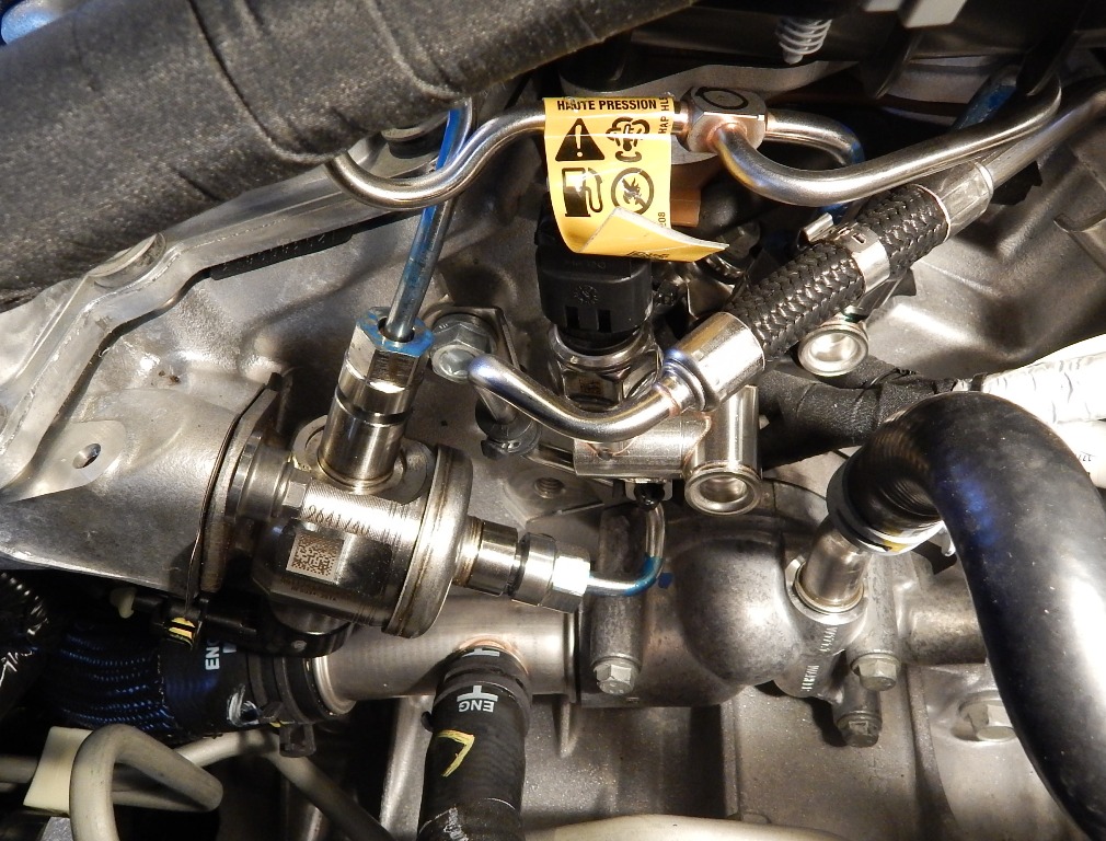

Just sharing a picture I took yesterday. I couldn't resist removing a couple of covers on my 3.6 LFX engine and snoop around. I was most curious about locating the fuel pump, and sure enough I think I found it!
It sure seems to me to be "external", and driven from the driver's side end of the front exhaust cam at a 90 degree angle. Thank goodness! Also, I couldn't get a good view of the fuel rails, but it does appear to me that they are also "external," apparently running along just under the plastic intake manifold and above the area that would have been the valley cover on the pushrod motors. -at any rate, I suspect it is all "external" to the crankcase, per se'.
So, here is hoping, that most all of the high pressure fuel is "external" on this LFX engine. The one area that I can see as being vulnerable is the seal on the pump drive end, which I suspect provides a pathway for leaks into the end of the cam cage, and of course into the engine oil. Bummer! Now my "old mechanics brain" says, "wouldn't it be nice if there was a "weep hole" at the bottom of the pump drive!! -just like old school coolant pumps had used for a hundred years!! JUST SAYING,,,,,, -ain't rocket science,,,
Maybe the teams of engineers involved thought it better to take the chance of ruining an engine, than to have it leak externally and create a fire hazard??
Tech2, I would surely appreciate your comments.
(yeah I know, I'm "over thinking things" again, but it's just who I am,,,)
And Thanks to everyone for putting up with me.
