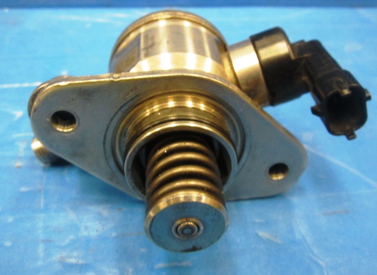

Oh my gosh, further research shows this for GM 12641740 high pressure pump: It is a mechanical push-rod actuated pump !! (image attached)
Sorry tech2, I guess I didn't make the connection to your reference to the old style diaphragm pumps. (those being mechanical too,,,) With the high pressures involved, I would think it must be some type of plunger or piston type design.
I still say it needs a "weep hole" just in case the push rod seal fails,,,
