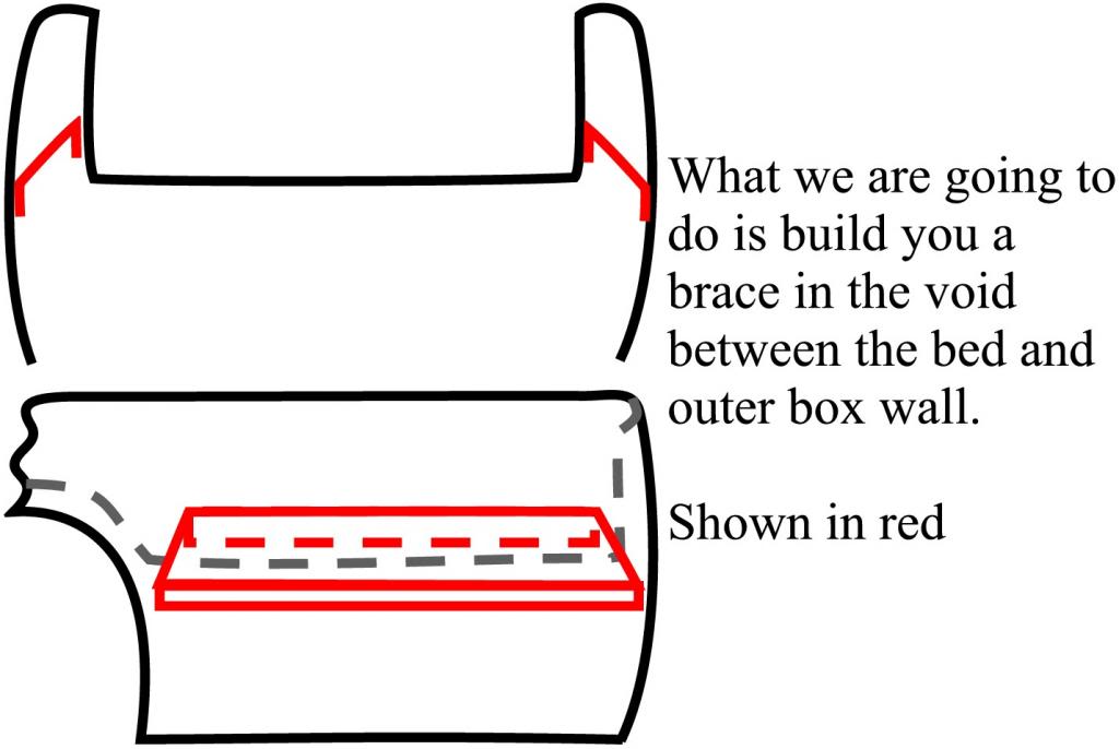

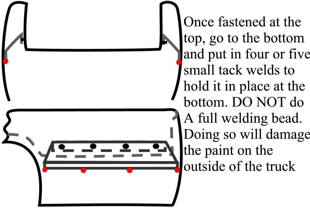

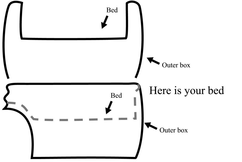

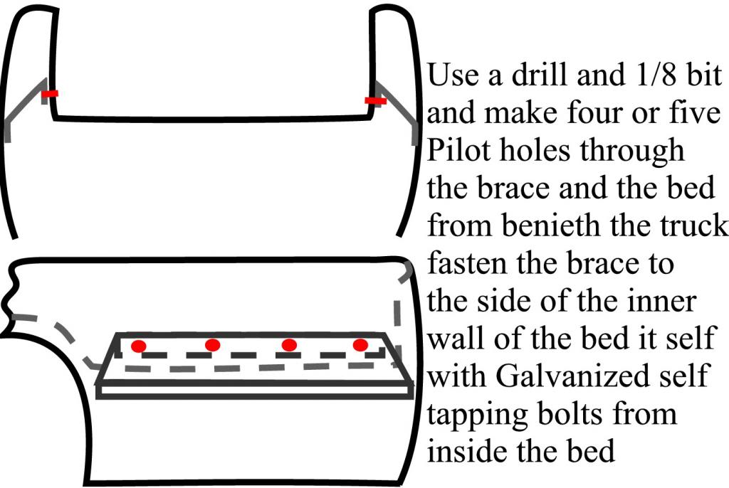

Now, understand, your truck, your call. It's up to you whether you want to try this or not, Don't feel obligated because I spent time on it, I may end up doing this one my self if I ever get a long box truck.
I am basing this idea on something I noticed with my 99 K1500 and won't guarantee anything. My 99 has a plastic bracket under the bed between the bed and outer box wall behind the wheel well to keep mud and dirt out of that void, it had the side effect of reducing the dents it would take. Did not eliminate them completely but definitely made it harder to dent.

Now, what it is that this will do is transfer a bunch of the load of you leaning on it to the inner bed wall. My self personally I would put it at the center point where it is at it's widest but if you feel it needs to be higher or lower based on where you are denting, it's your call.
